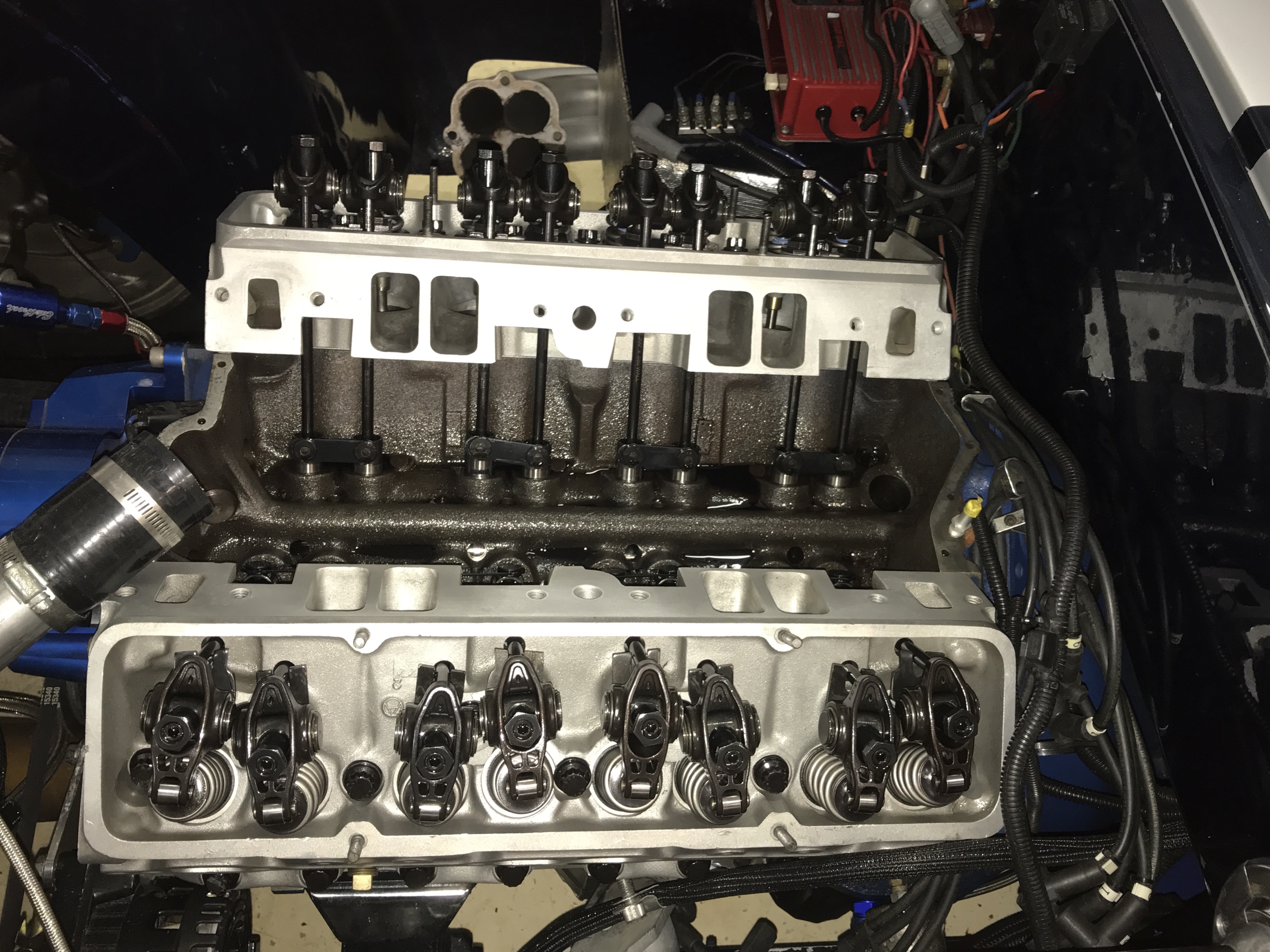

I was a little lazy this weekend and didn't finish the motor assembly, but I got the hard part done. Heads all torqued and the valves run.
I took the time to CC relitive parts and ran the compression numbers. I don't know how much cutting was needed to true the heads the chamber is now only 60cc's I think they were 62 before and are supposed to be 63. the gasket is .039 compressed..the magic numbers came out to 11.1.
I couldn't find my cc vile when I put it together this last time so I don't know what it was then. The compression is around 255lbs so I was suspecting that it was at least 10.5.
The pistons and all internals look good and there is no pinging (at least not pinging loud enough to hear over the pipes, lol) and it starts without lugging and doesn't run hot so I think all is well. I do know that aluminum heads will allow more compression than steel so I'm not going to ge too worried about it. Just have to look for good gas stations. And I may start putting in a little octane additive.

Looking very good Ken, those are some healthy intake ports you have in those heads.... ..]

WooHoo.....Motor running again.
All's well in the garage again. Just a little too rainy and cold to test drive but SOON!
