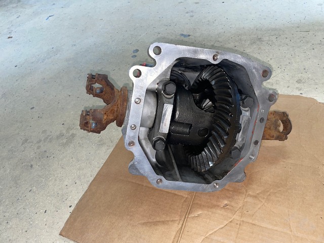

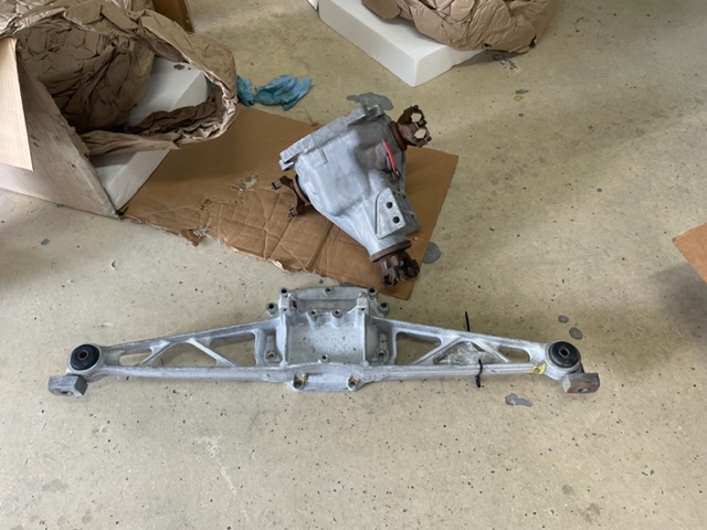

When I bought my kit from Hunter (I just talked to him and he is making cars again) he asked me if I was going to run a Big Block. I told him no so he picked up a small block automatic donor car.
I have to admit I knew a lot about corvette body and basic mechanical stuff. But I had never heard any thing about the Dana 36 vs Dana 44 durability. And as I wasn’t planning to do track days it didn’t matter at the time.
It took a while but my gradual HP evolution finally broke the Dana 36.
I will have to make some modifications to the differential carrier but not too much fab work. I’ll post the process here.

Looks great!
It is aluminum? I thought that was auto trans only?
PS: Glad to hear the virus is on the run for you.
Posts: 686
Re: Differential upgrade

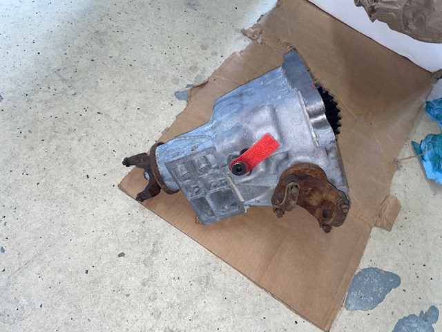

No it’s steel, just painted to look good on eBay
The batwing is aluminum..of course I’ll be cutting all that off to just leave a rear cover.
Dana 36 and 44 cases are both aluminum. D36 is auto trans, D44 is manual trans.
Ken, how much did it cost you? Curious to know current pricing.
