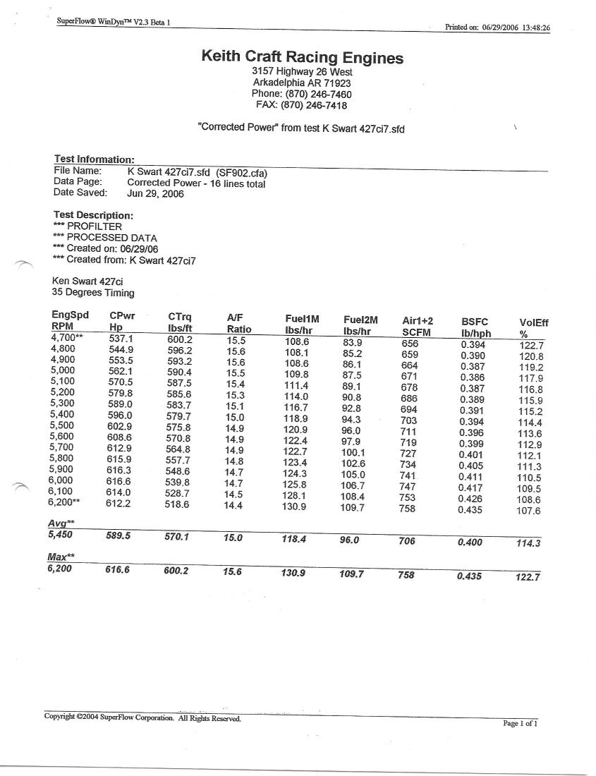

Dyno sheet indicates timing set at 35 degrees total. A/F ratio appears much more lean in power band than I'd have expected (15 avg). I'd have expected more in the 12 to 13 range in that band. If as you say, the motor is running very rich, something or several things have changed since that motor was dyno'd.
