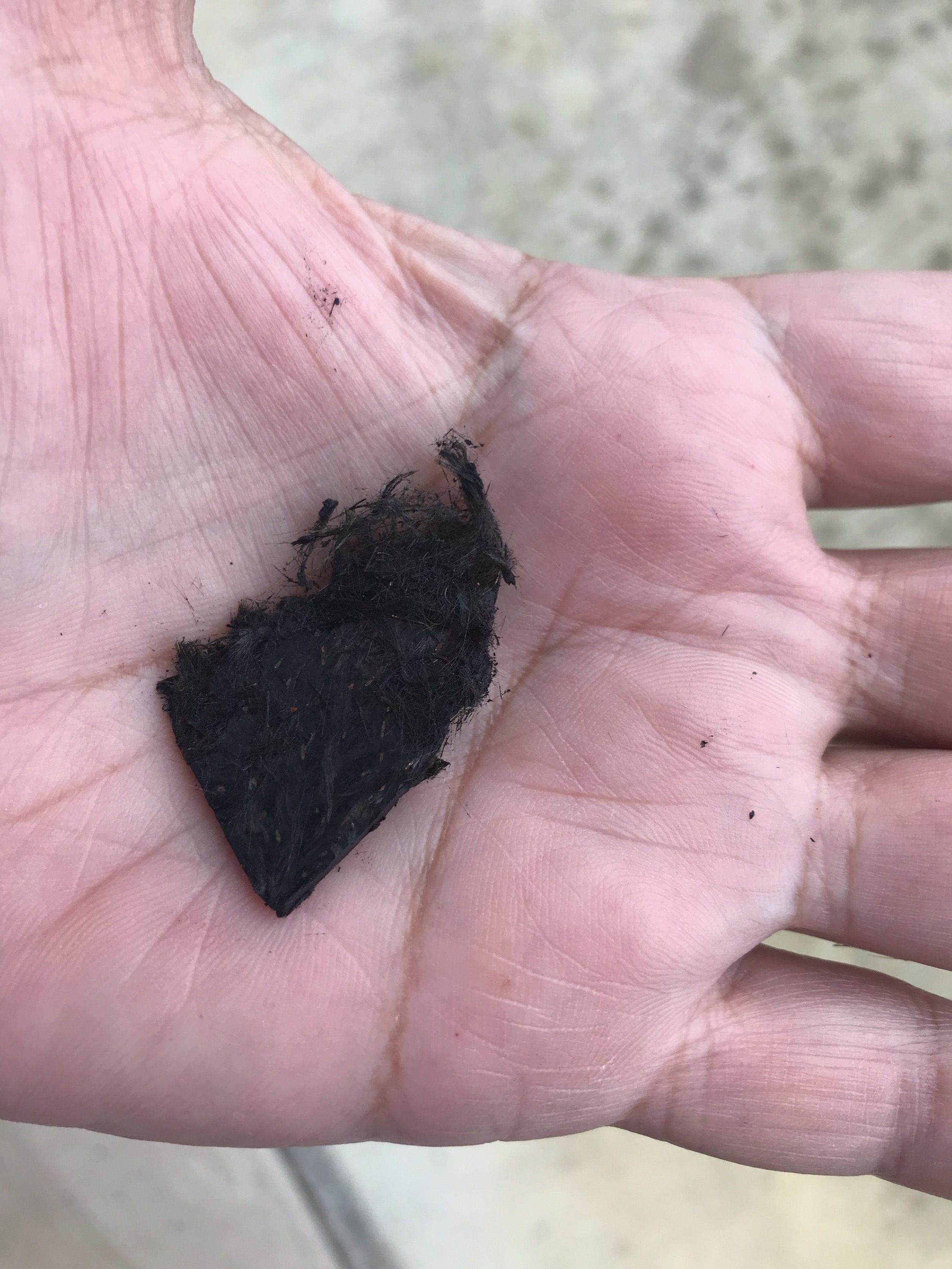

Went to Mike's today to help with the final bleeding of air out of the clutch slave cylinder. While we were trying to do that, Mike said the boot felt odd, and a piece of clutch facing fell out of it. It would seem the clutch itself has failed, so the trans will need to be pulled and the clutch, pressure plate and maybe the flywheel will need to be replaced.
Here's the picture:
That seems to be part of the price of enjoying the full Cobra experience. ~~(/)

And that's just what was found in the rubber boot covering the clutch fork outside of the bellhousing, I can only imagine what we'll find inside once the bellhousing is removed... :eek:

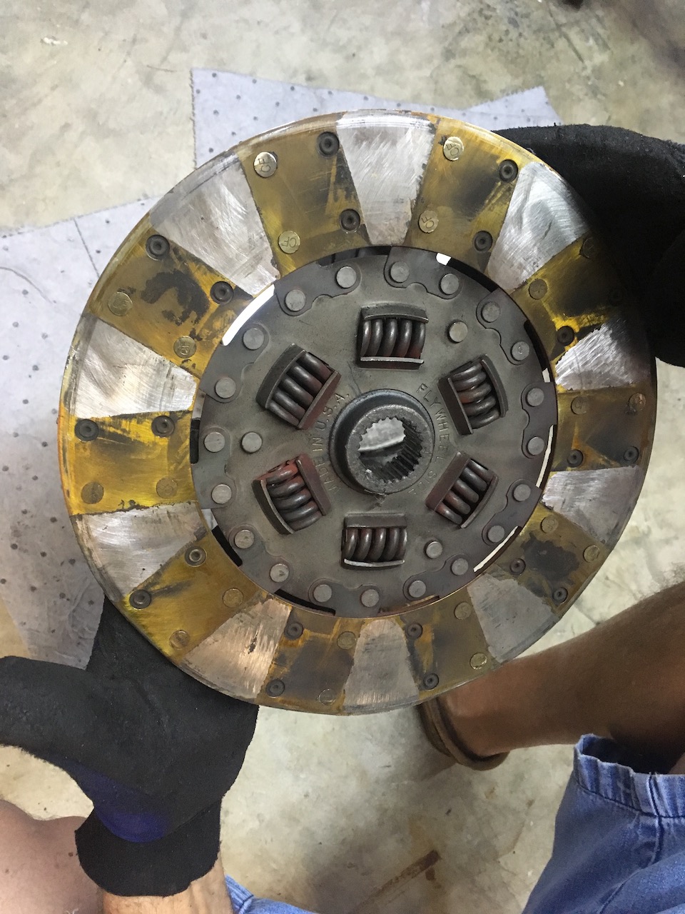

What Mike decided was the problem turned out to be true:
Mikes Disk-no facing web.jpg (318.99 KiB) Viewed 13774 times
The flywheel side shed all of its bonded facing. Sad that the adhesive only lasted 20+ years ~~(/)
On the positive side, the flywheel looks OK. As you can see there's almost no evidence of metal to metal contact. The other riveted side is still in very good condition so the pressure plate is unharmed.
New parts on the way - we have the Cobra on the lift and the new stuff should bolt right in =))

This is what the disc should look like...my guess is that one broke loose and proceeded to take the rest with it in a speedy chain reaction... O::::
