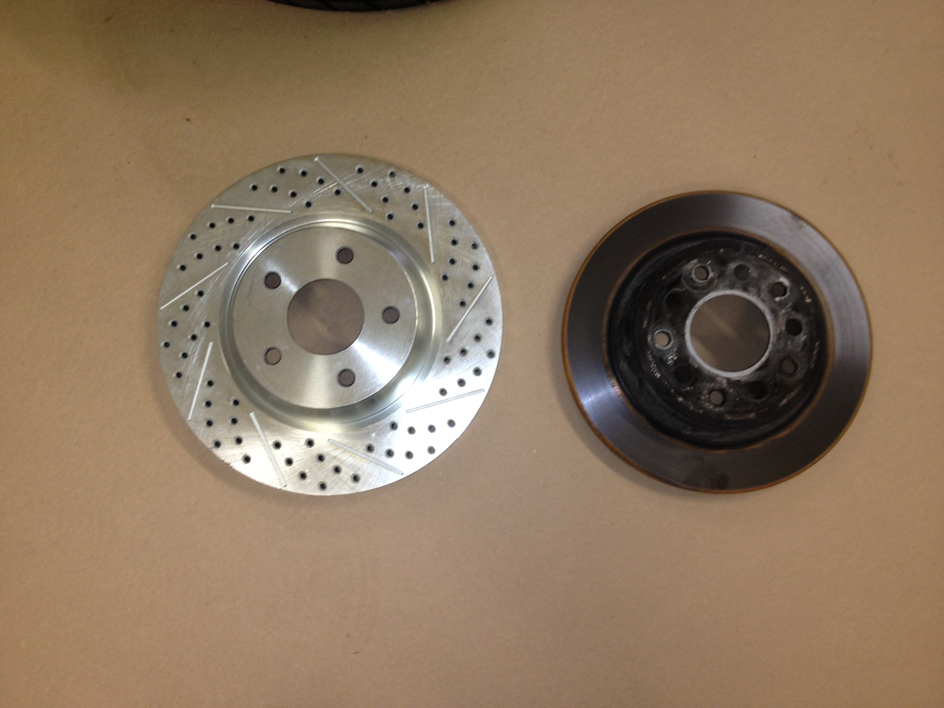

Hi Tom, I didn't want to start a new thread to show you how much larger my Baer brake upgrade 13" rotors are over stock.
So I hi-jacked Mikes....
Posted: Sat Aug 24, 2024 10:06 am
Know them well! I have the same on the fronts of the Cobra and the Zephyr. Wouldn't leave home without them LOL
