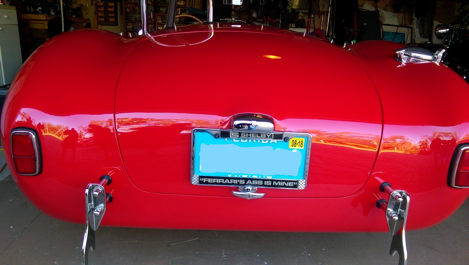

Stopped by Stefan's house briefly this weekend to say hi and he showed me his new license plate frame... ..]
