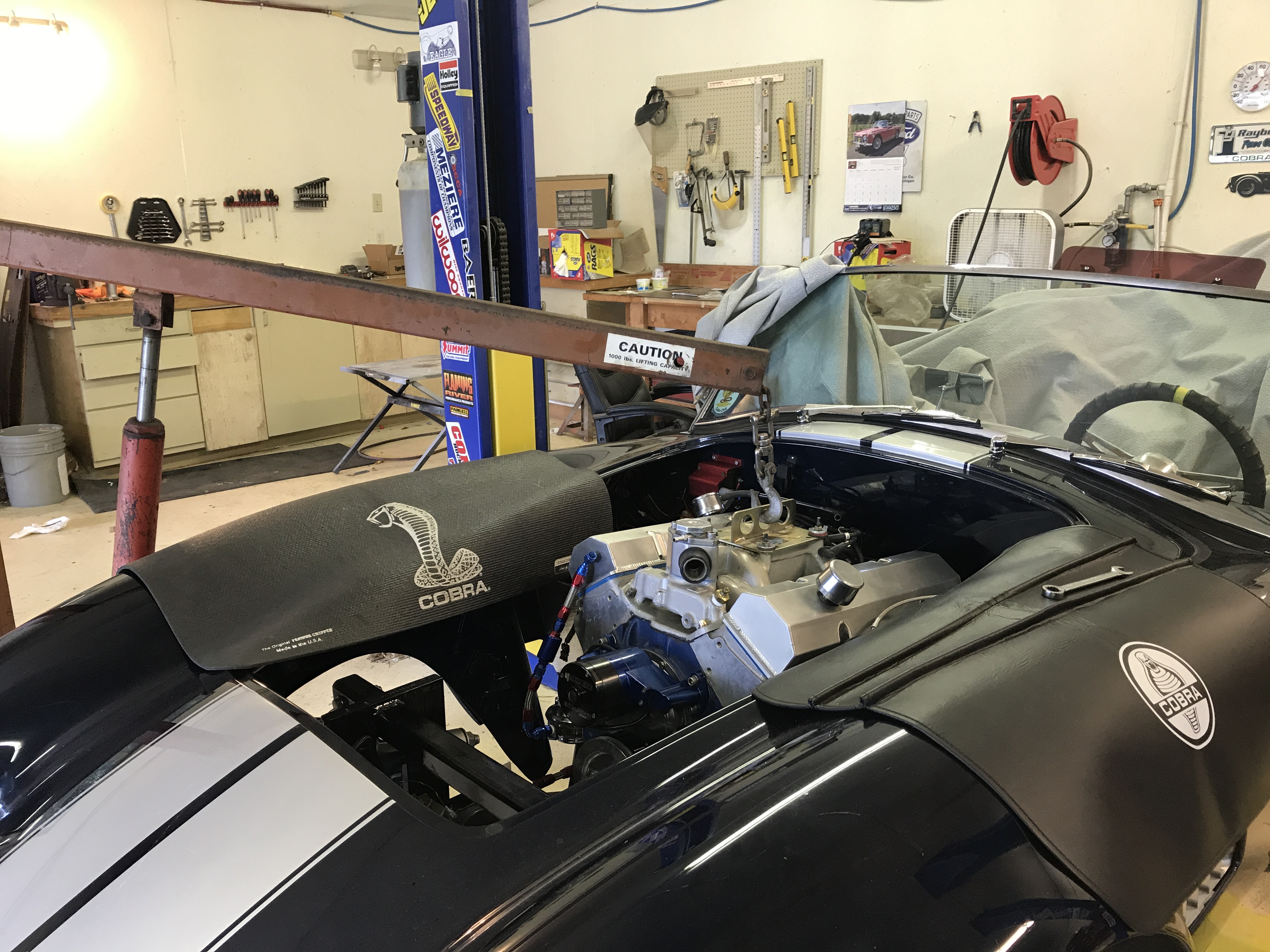

Motor and transmission back in their spots.
- 0525069C-B4BB-4095-A294-99086A06C47C.jpeg (2.53 MiB) Viewed 17003 times

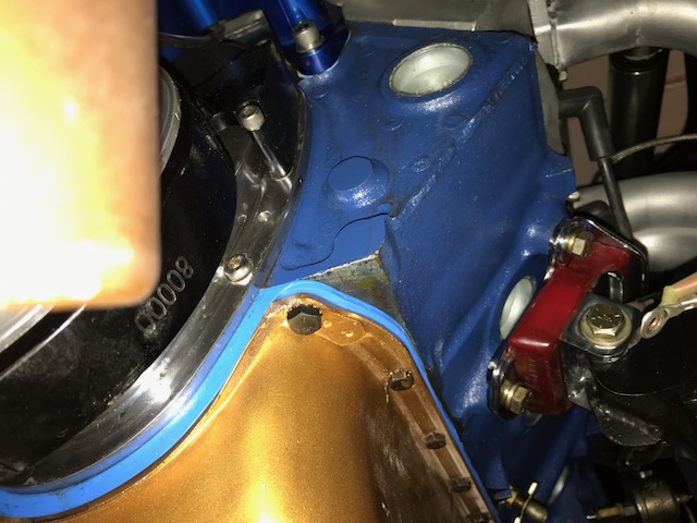

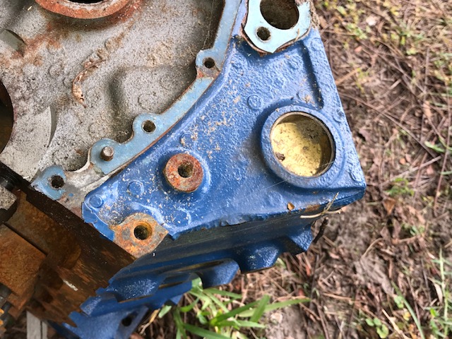

As the old saying goes. "What is wrong with these pictures"?
The alternator was the last part left to bolt on however as the pictures show no holes.
Sure wish I had seen the holes missing while the motor was out of the car.
Had to pull the electric steering back out but I can get to the bosses. So its just another aspect of the hobby. As I keep telling myself, if there were no problems to fix....why have a hot rod cobra. If no problems all that is left to do is wax it....I hate waxing.
