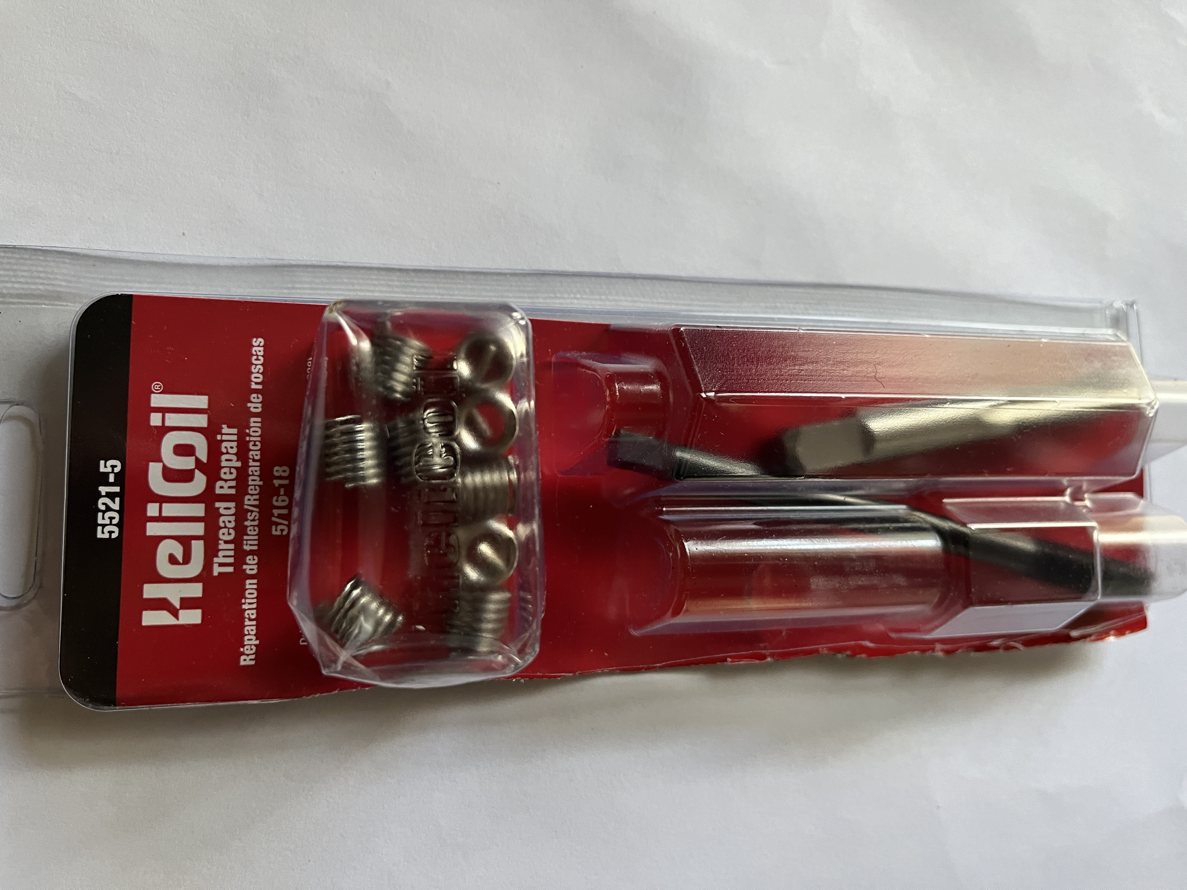

Next up is to repair the clutch bolt holes in the aluminum flywheel, they’re pretty well chewed up and one is drilled/tapped OS, so I have to decide which way to go with it. I think the easiest path is to enlarge and tap the other five holes to match the OS hole…🤔

BTW, would it be practical to HeliCoil the clutch bolts? I'm sure I have some HeliCoil pieces - whether they're the right size or whether they can be found are other questions...

It will depend on if I can helicoil the OS hole to match the other five.
Posted: Sun Feb 11, 2024 7:54 pm
I was being a little Plan-B-ish. I was thinking HeliCoils for all the clutch bolts.

Tom, I need 5/16-18 helicoils, do you have that size?
Never mind, Autozone has them… :grin: 8-)

The set needs a 21/64 bit. The only one I could find here is about a foot long - you're welcome to any of it you wish.
I was thinking about getting the Cobra out in a bit - I can drop them off.

Thx for dropping it off Tom! I have a 21/64 drill bit in a typical length, so that should work out. I fashioned a drill guide that should ensure straight drilled holes. I’ll post pictures tomorrow when I go through it, had too many distractions today.

The drill guide worked out well, holes were drilled straight and the tap had no problem following the hole. I lined up each hole with the starter opening in the backing plate so I could drill and tap with no interference.
