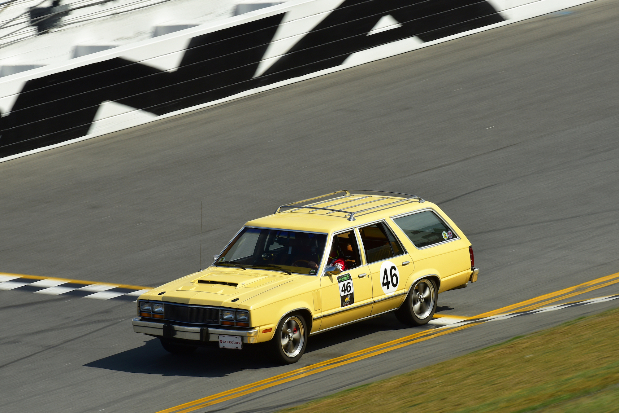

I've signed up for the SCCA's track day (PDX) at Daytona on Friday, May 5, 2017.
Their rules allow for a pit crew, so if anyone has enough loss of sanity to want to do this, let me know. I'll need to get a firm idea so I can put the name(s) on the list for their free pit passes. I know at least four are allowed, maybe a couple more.
I plan to take the Zephyr, so if they let me run more than one session I will probably buy a lottery ticket ..]
