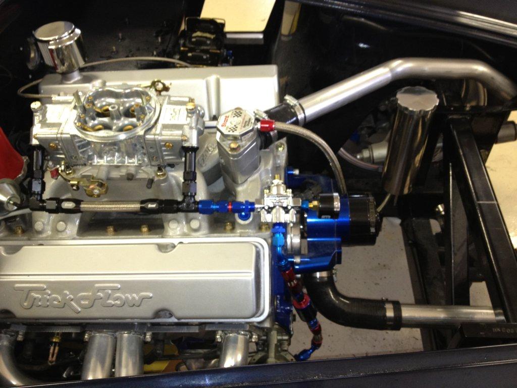

Brian,
I did mine using SS exhaust tubing. It may be hard to find a 90 that is a tight enough bend.
I bought a roller to make a ridge at each end, but it only works on really thin SS. I ended up having Rick's muffler shop weld a bead around each end to prevent the hose sliding off.
If you'd like to try the tool, you're welcome to borrow it when I get back. Also, I've seen a homemade ridge-maker made by grinding the jaws of a pair of vise-grips.

I didn't use stainless but I did use aluminized steel exhaust tubing. I rubbed it up slick and put Shark Hide on it to keep it fresh looking. I made a tool out of a vice grip with the bottom half of a muffler clamp and a small piece of round stock welded to the jaws to crimp the bead in the ends to keep the hose from slipping off.
If you want I can post a picture of the tool. It took a few minutes to make the bead but it did a good job.
