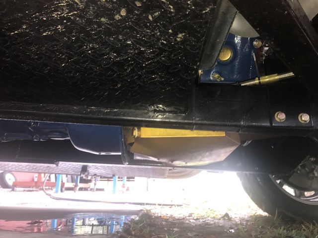

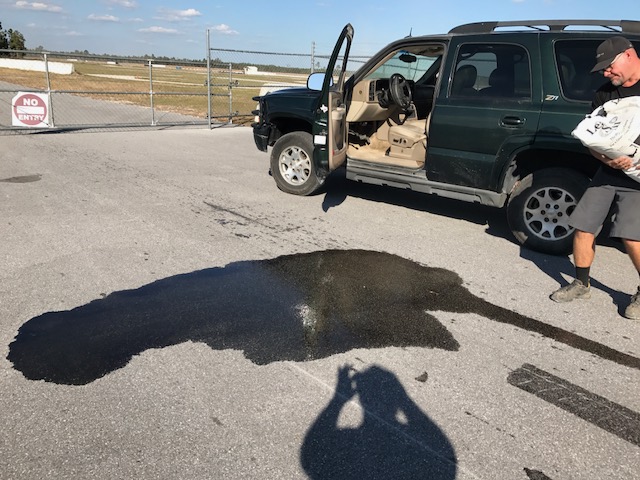

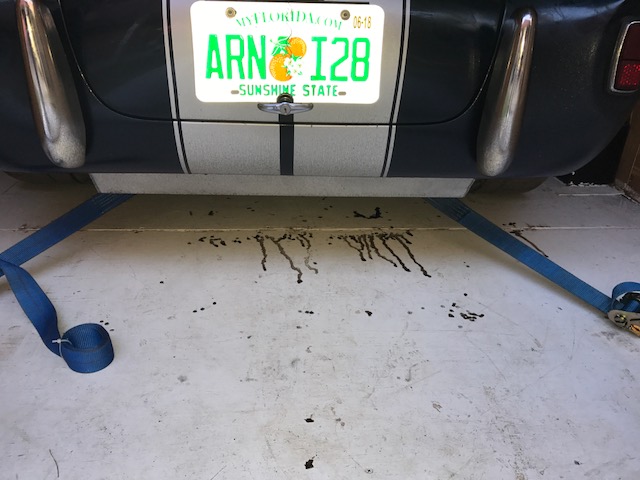

After lunch I ran two sessions and all was well. Now as to the 3rd run. Not so much. as you can see from the photos I think some of my pistons decided that they wanted to try swapping to another cylinder or something. Any way my new oil change with about $100 of Royal Purple oil ended up on the track. :GR::

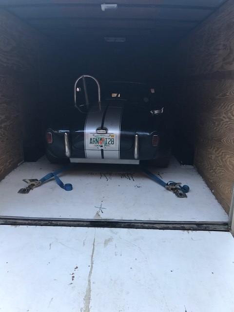

The photos also show why I trailer my car to the track....I know how I drive. :ymdevil:

Yikes, that first shot looks like the Exxon Valdez oil spill.... :W:
I'm guessing a rod let go? Did you miss a shift and over-rev it?
Re: A Day at the FIRM
No missed shift. Don't know what went first yet. A piece if the piston at the ring came out as I pressure washed the oil off. No water came out that I can tell. Bottom of the oil pan is all beat out.

Oil Pan.
'nuff said! ~~(/)
'nuff said! ~~(/)
- IMG_0680.JPG (87.39 KiB) Viewed 9913 times
Looks like the rear part of the oil pan opened wide and said AAAAHHH.
Keep us posted as to what you find when you get it all apart.
