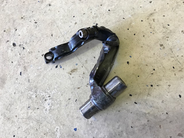

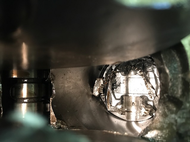

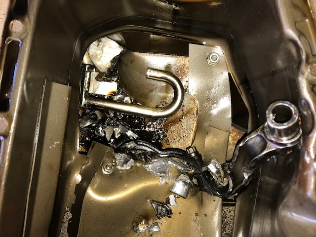

I pulled the motor today. The damage is about what I expected. Thou I have not seen a connecting rod this bent before.
Looks like it was the piston that gave up first....not that it matters all that much.

Ouch!
Thorough destruction. Way above average...
Was the pin seized to the remnants of the rod? Could that have happened first and then the piston cracked to pieces?
It would be interesting to try to pinpoint (sorry, no pun intended) the initial cause of the failure.
If the pin froze in the small end of the rod, it might point to a lack of lubrication.
Did the crank show anything on its bearing surfaces?
This will be a good test of forensic accuracy :(
Let us know what you think!

SBC piston pins are almost always pressed into the rods, so unless Ken went with full floaters, I'd say a rod bolt let go or the piston shattered. :W:

The pins are press fitted into the rods. So far oiling looks ok other than the journal that gave up. However I have not taken the crank out. Its all in a nice neat bundle on the stand for now. I'm gathering up parts info and such at the moment. I've decided to go with the 421 ci. instead of the 434 ci. I'm just afraid that pushing everything to the max will come back and bite me. The 421 is 3.875 stroke with a .030 bore. 4.155". I will be upping the compression a little too.

The piston seems to have broken thru the wrist pin area, all pieces below the pin are smaller than a marble no big chunks.

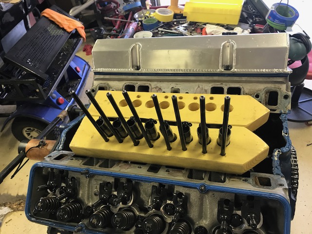

Sometimes it the little things we make that we can be most proud of. I'm using the cam over so I made this to keep the lifters and pushrods in order. I might have even saved $29.95 from Summit Racing.

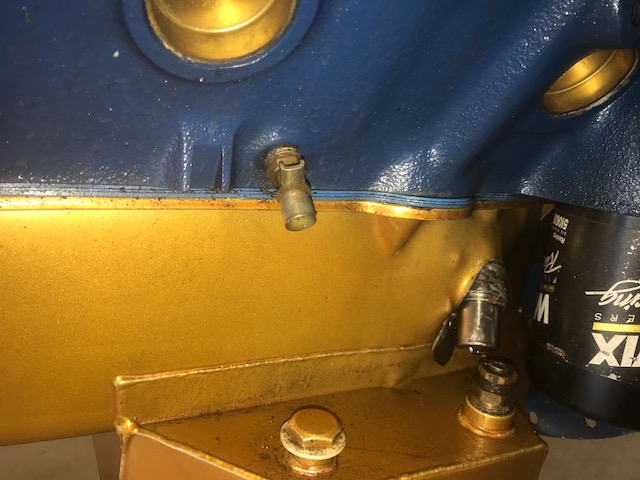

Ken I guess this must be another one of those little things but I noticed you have a petcock installed on your block. Great idea do most blocks have a tap to do this or is it a SBC thing
Re: Motor damage
Yes all SBC's have a pipe plug on each side. It makes it a lot easier to manage the water. I had heard that some tracks don't want anti-freeze so I added these to drain and save (with a hose on the petcock) the anti-freeze if needed.
Re: Motor damage
I've always installed petcocks on those drain ports on all of my engines, but the rust and silt that always clogs the port openings clogs the petcocks even worse, rendering them useless. Kind of like the shutoff valves under the sink that never work when you need them...:-(
