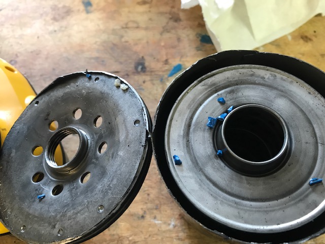

After Daytona I had the balancer issue that I wrote about, but I also noticed on the last run that the oil pressure was lower than normal. So I cut the oil filter open hopping not to find little shinny stuff.
No shinny stuff but a lot of large (for an oil filter) blue stuff. There were a lot more pieces than what is shown in this photo..I didn't think to take a picture.
Oil Filter
Oil Filter

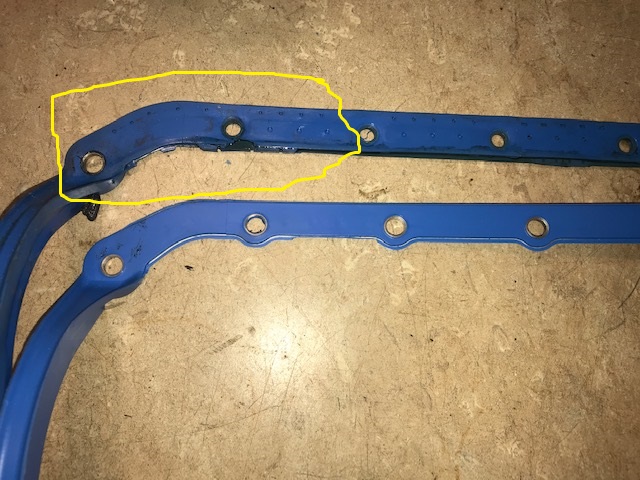

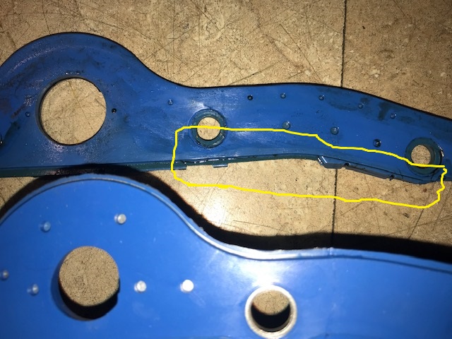

I knew that it had to be the oil pan gasket so after removing the Circle track pan I took a look. It seems that the longer stroke on the crank shaft was hitting the gasket. This also explained the oil leak that developed after the miles were adding up.
Pan gasket 1
Pan gasket 1
Pan 2
Pan 2

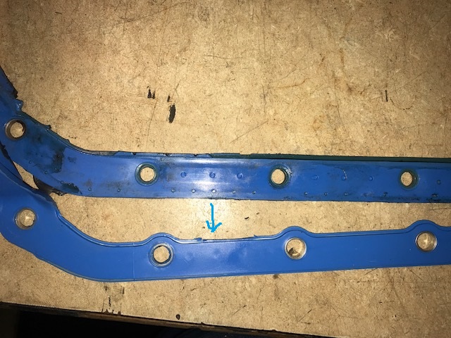

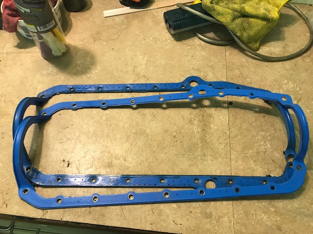

The gasket is a Fel-Pro and it is the good one. However I had ordered it from Summit just via the motor needs as in Small block Chevy Gen1...when I got it I noticed that it had provisions for the dip stick to be on either side. While that did not seem to be a problem the shape of the gasket was.
For the replacement gasket I got one with only one dip stick hole and I was prepared to trim the gasket to fit the new crankshaft. BUT to my surprise when I put them side by side the new gasket is shaped so that the crank shaft can not reach the gasket... ..]
