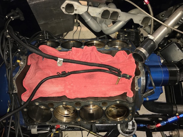

As I was driving in the Reptile roundup cruise I had a fair amount of smoke coming out of my right side pipe. As I had just changed the oil pan to a road race type, I was hoping that maybe I had just over filled it.
So as the saying goes I was whistling past the grave yard. :-?
The compression test was good - 250lbs but oil was starting to drip from the side pipe. So off with the head!!!
Cylinders look ok but there was standing oil on the tops of several pistons. After taking the head, intake manifold, piston and all gaskets to my engine guy that I use for the stuff that I can't do, it appears that the valve stem seals have crawled up the stem. So I pulled the other head and am taking it in also to do a different brand of seals and he is going to set the spring pressures while he is in there.
SO here is a picture of my cobra motor that is not in a state the it should be for this time of year with the cooler temps....but as I keep saying " its all part of the hobby, if I don't have to work in it then all that is left to do is wax the car....and I hate waxing." lol

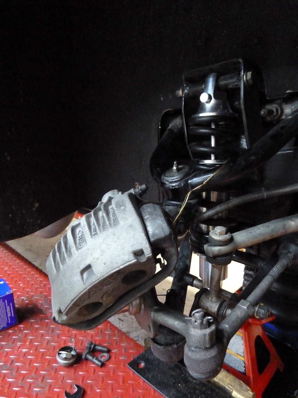

I took the Cobra's front end apart because after 38K miles the front wheel bearings developed some play, and the brake disks were worn. Any rational human would probably have turned the disks, thrown in some pads and regreased and retightened the bearings. Not I!
First, I did note the shocks seemed to have relaxed, so, using the part number I preserved these 18 years, I ordered new shocks. The result is they were not the same ones that I removed. They are 1" longer. Reasoning (rationalizing?) the suspension had relaxed to the point that the upper A-arms were hitting the inner fender panels, I installed them. Will they make the front end sit too high? Still in the drum roll on that one...
The shocks I removed did have nearly zero internal gas pressure so at least replacing them was a good idea.
Next, I removed the wheel bearings from the hubs, installed the outer cups no problem and set to installing the inner cups. After ruining one hub in my 20-ton press I alertly determined the cups I bought were about 0.030" too large in diameter, and even a 100-ton press wouldn't have made them fit.
I have ordered a new hub from Baer who apparently thinks it is equal in price to its weight in gold. Education is never free...
I haven't even tried to install the new rotors, or the front or rear pads. Oh joy! I can hardly wait.
So for the moment - until the hub comes in and I can start putting things back together - here's what it looks like:

As they say I feel your pain. The longer shocks will not matter unless they bottom out during normal travel at your previous ride height. They might have an o-ring on the shaft to indicate travel. If not a small thin zip tie can be used.
If so the only solution is to raise the ride hight or stronger springs to keep it from compressing as easily.

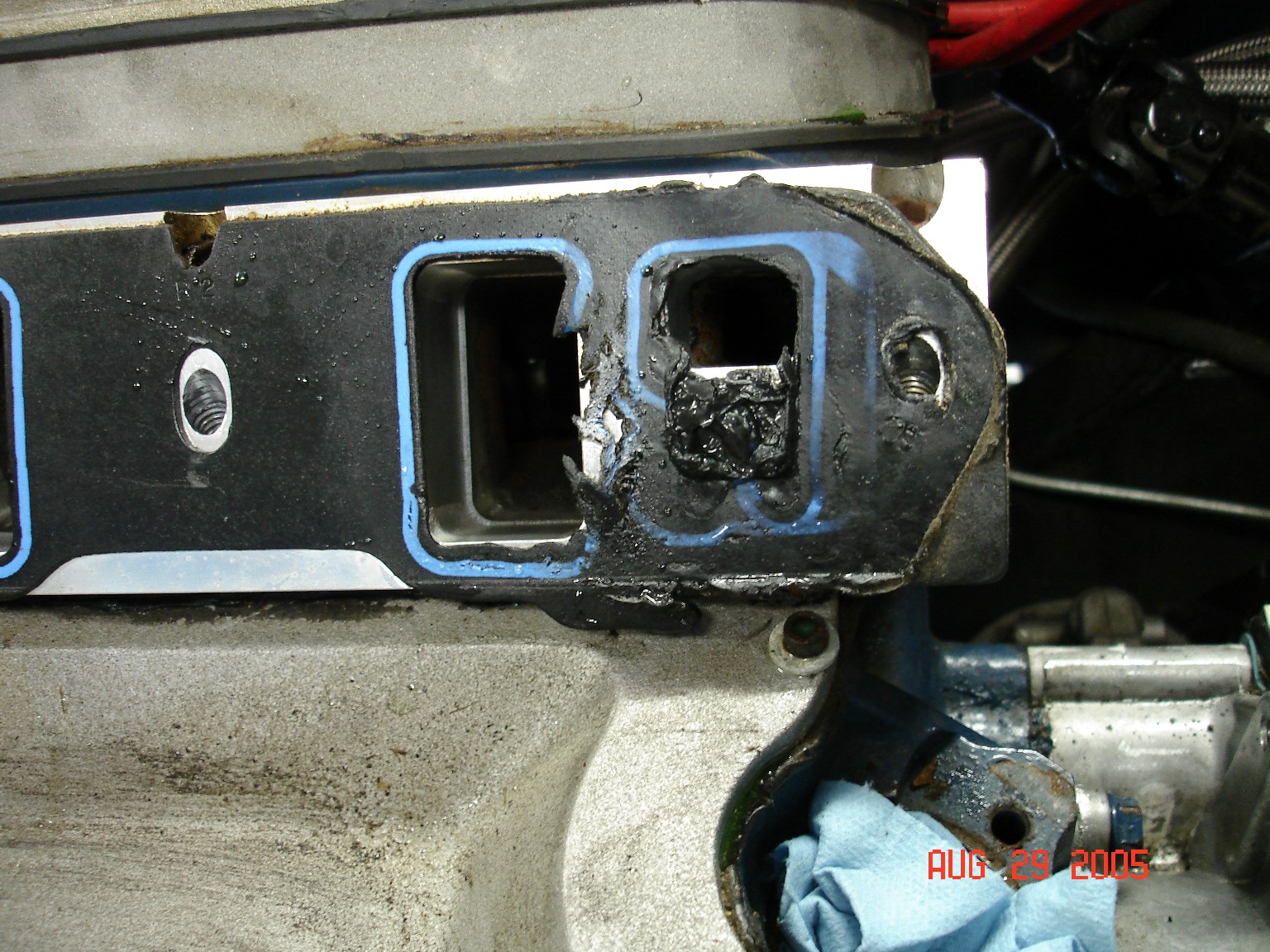

As to gaskets, make sure the new ones are not like the old Fel-Pro Print-O-Seals that didn't have any steel shim core, so after a few dozen heat cycles they would creep outward and fail. We ended up calling them Fail-Pro Print-O-Leaks.
Here's an example (one of several different engines/assemblers that are in the file, all with the same problem):
The worst effect of failure was coolant in the oil. It didn't seem to matter if they were used on big (460 or FE) blocks or small blocks. Same result.
Those gaskets were made for and used by racers. The bad news is they did not last very many heat cycles before they crept out of the joint. What the racers did, of course, was to replace them frequently in the course of normal maintenance and so they never ran into the higher number of heat cycles that a street engine experiences.
Some race parts are not usable on the street - those were a case in point.
