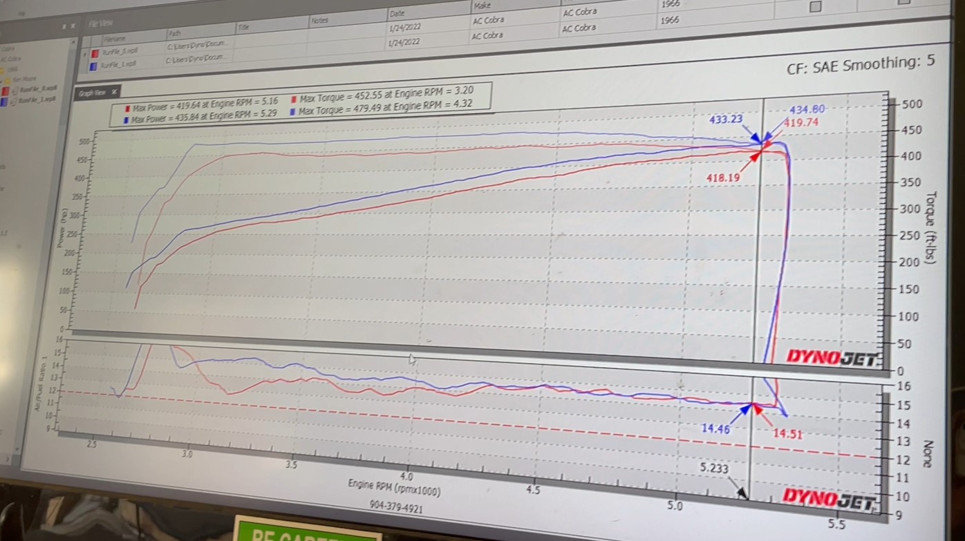

This is one of the first pulls. 433hp 418tq
The A/F ratio is in the lower section...14.5

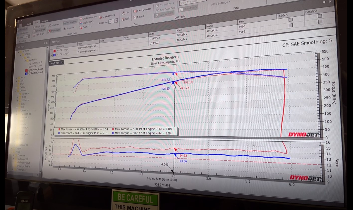

Last pull A/F ratio is 13.0
:arrow: I gained around 30hp just by jetting the carb.. :whistle:

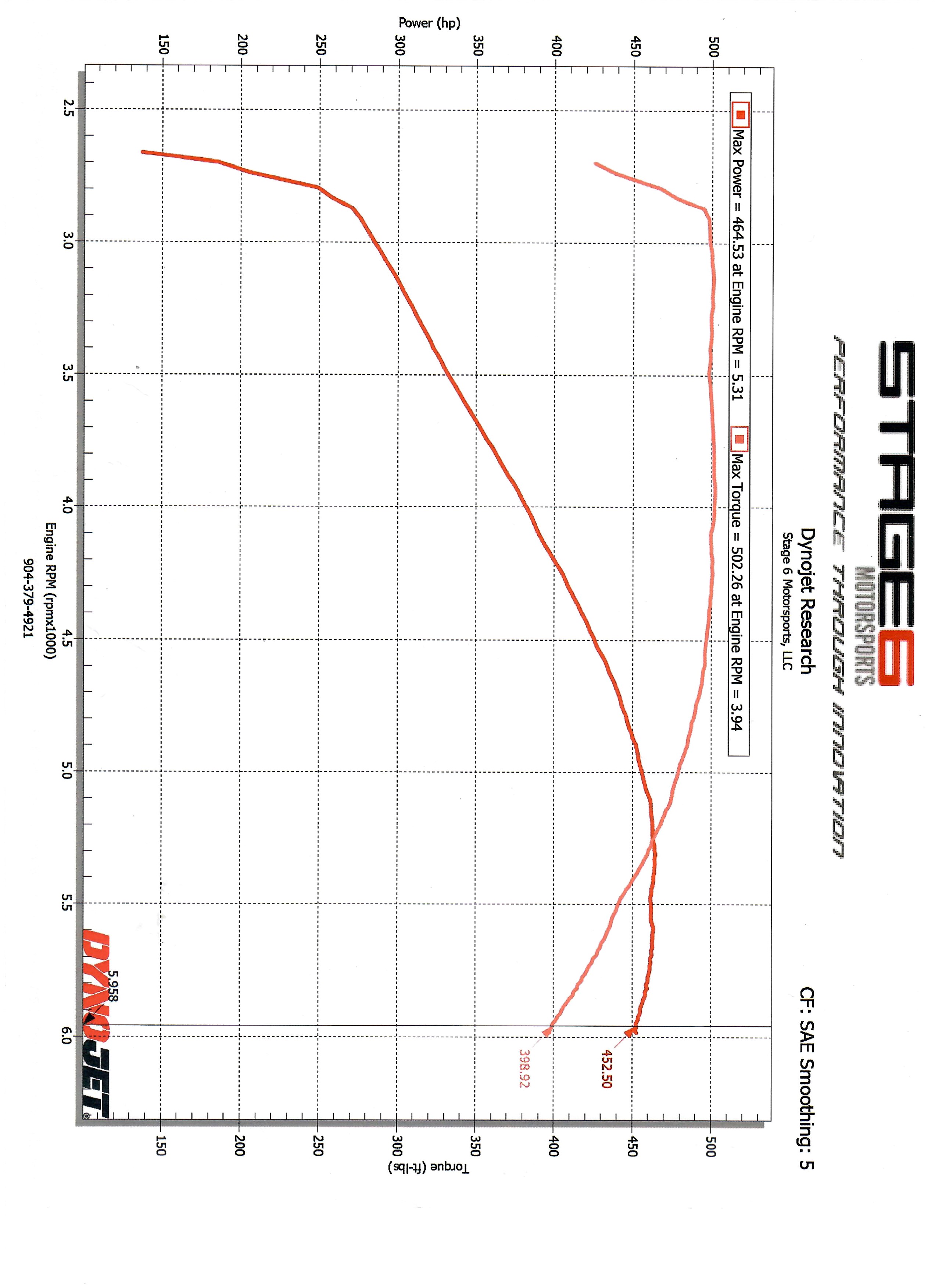

Dyno sheet.jpg (742.58 KiB) Viewed 7082 times
:arrow: :arrow: :arrow: 465hp 502tq at the wheel :dance:
It made more power than I expected. :lol:
as the rule of thumb is there is a 75 to 100 or so hp lost to the wheel....it makes the number even more impressive. My first 406 made 455hp and 485tq at the crank...Same heads, cam, and intake. Stroke and compression is a good thing.
The shop also told me that it was the highest numbers of any naturally aspirated small block that they have run so far... :clap: :dance:

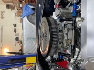

Also on that note I’m always a little embarrassed when I open the hood do to the 12” air cleaner that I have for hood clearance.
The boys at the Dyno shop wanted to see how much Hp my dinky air cleaner was costing. As they have seen some that they have tested lose 30hp and expected the same.
In fact he had already unhooked the sensors and was winding up the cords when he remembered that he wanted to do the test. I told him that it was ok and I was going to try and modify the drop down style air cleaner base anyway.
But he said he wanted to know so he hooked it back up.
We did the pull and…..there was no change at all. Only a .1 ratio leaner. We were all surprised. So more money saved. I was going to buy enough parts to try and make a new air cleaner and that saved enough that it paid for the session. I guess that makes it free..lol
