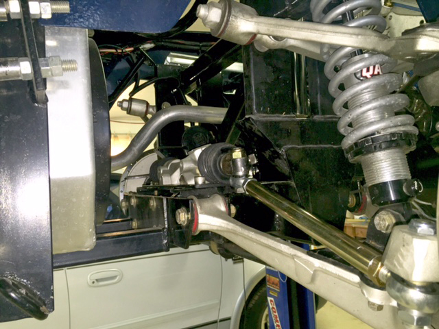

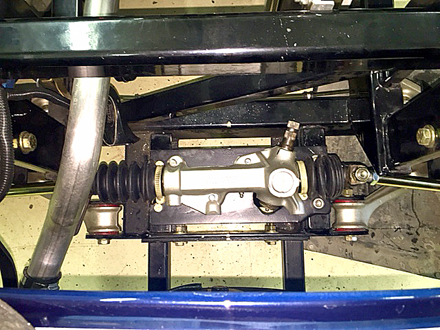

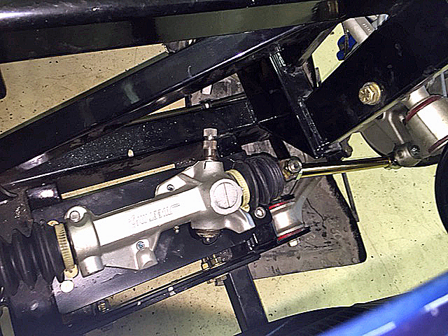

My Kit came with a cut down Pinto steering rack. While it does work and has easy effort turning while sitting still it is a little over 4 turns lock to lock.
I have replaced it with a Sweet Mfg. Dirt Late Model Steering Rack. 2 1/2 turns lock to lock. I have also changed the tie rods to Heim joints.
Im still waiting for the U-joint so show up so I have not had a chance to road test yet....but it sure looks sexy sitting in there.
