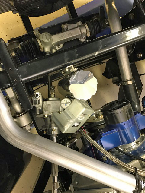

- Ill be taking off everything except the power unit at the top.

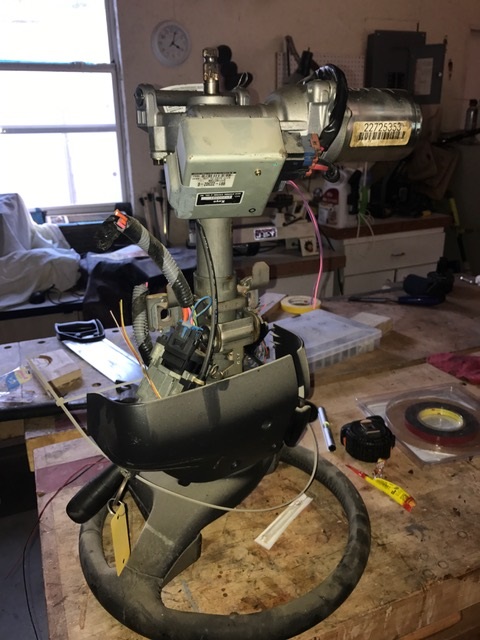

Here is the box removed from the column.
Looks like I have room for it in the frame. I’ll have to move the radiator over flow but it should fit.
Still no idea how Ill end up as far as support bkts...but that is all part of the fun.

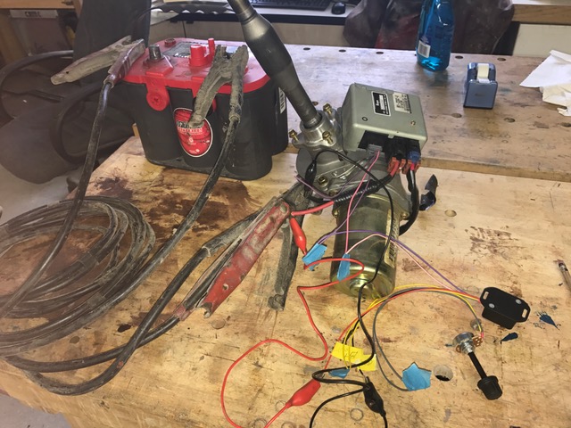

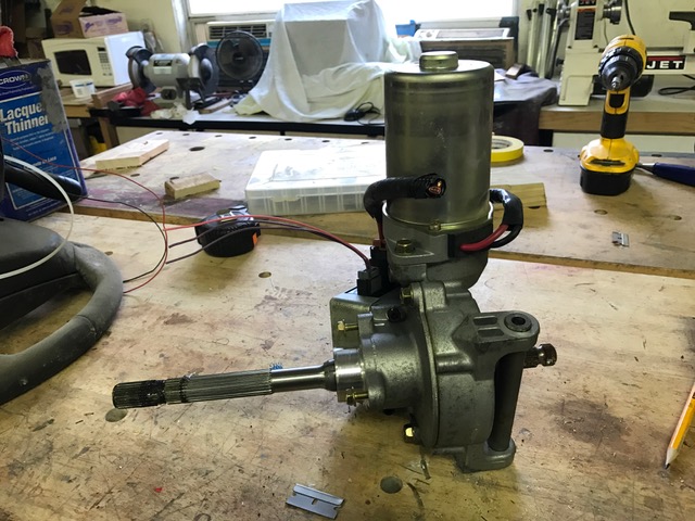

Weather has cooled so I have started to start on the project.
I set everything up to bench test. It works.
More pictures to follow.
- IMG_0097.JPG (117.04 KiB) Viewed 23775 times

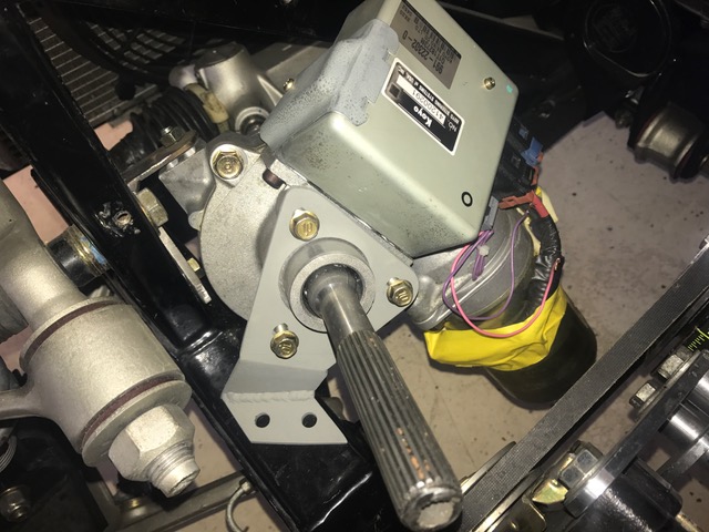

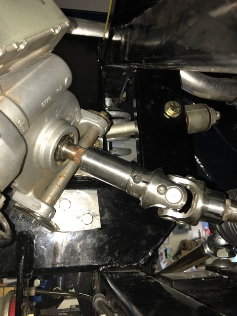

After lots of planning it seems that my planning is only good as practice for more planning. The steering box will fit into the space I have, but only just. The cute bracket I bought won't fit into the space so unless I can cut it up and use the pieces for the yet undecided new bracket it's just an extra piece to lay around the shop.
But as they say that is where the fun is......
I still feel I can get it all mounted...I was hoping to make the bkts so that they would bolt in and not have to weld anything. That might have to change.
So far I have not done anything that can not be undone if needed to put it back the way it was.
I have the box sitting between the U-joints and is hanging on its own so I should be able to make some cardboard templates to help with the fabrication.

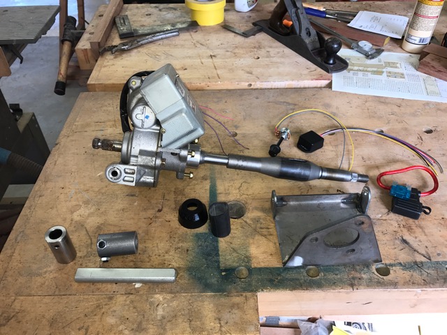

- The output shaft has a 16.5mm spline. I bought a coupler that has a 3/4 round on the downstream side that I will weld a DD shaft to mate with the DD U-joint going to the rack.
- IMG_0111.JPG (108.89 KiB) Viewed 23759 times
- I cut the factory slip input shaft and tacked a DD coupler to it to mate with the column U-joint.
- IMG_0117.JPG (89.97 KiB) Viewed 23759 times
- When finished I will replace the DD steel with a Stainless Steel shaft to the column.
- IMG_0110.JPG (88.08 KiB) Viewed 23759 times

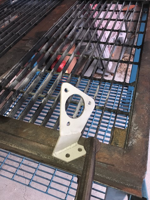

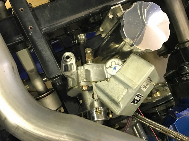

Re: new Project. Electric P/S

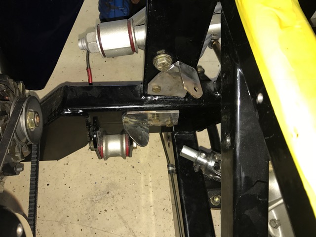

As I figured I was not able to use the bracket that I bought for the unit. These are the ones that I have made so for. I still have one more for the input side of the unit. However I am happy with these. I was able to bolt them in so no welding to the frame was needed.
I should have the remaining bkt fabed up this weekend.
Enjoy the photos.
Enjoy the photos.
- IMG_0124.JPG (105.2 KiB) Viewed 23740 times
- IMG_0123.JPG (81.62 KiB) Viewed 23740 times

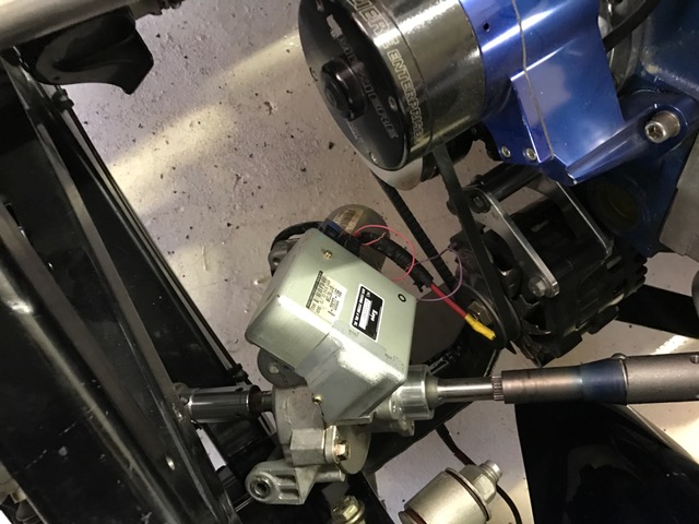

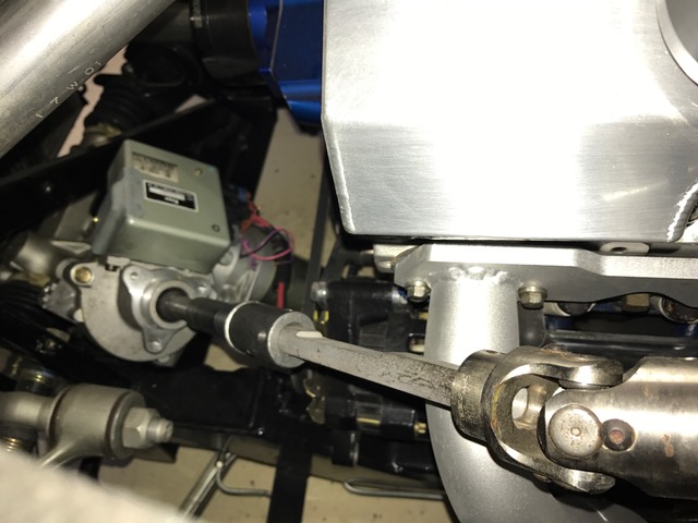

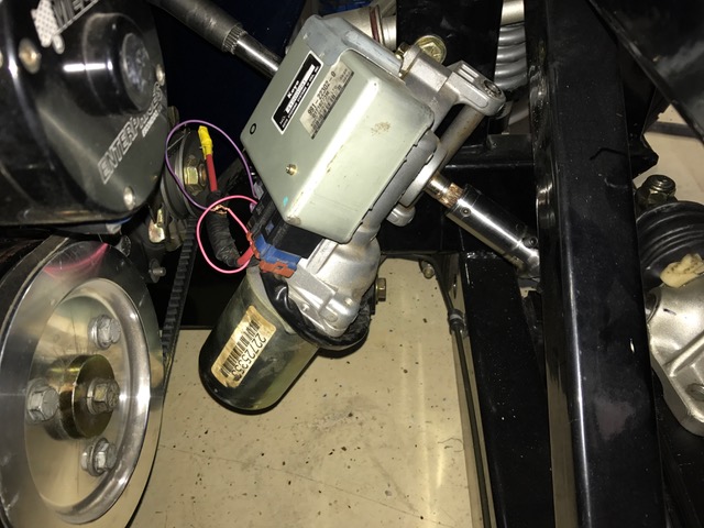

Last bracket is complete. I need to get the "rattle cans" out and make everything nice and pretty.
All that is left is to install control module and amount of assist knob and run the wires.
Next update should be how it feels when driving.
- IMG_0134.JPG (113.64 KiB) Viewed 23704 times
- IMG_0133.JPG (148.78 KiB) Viewed 23704 times
