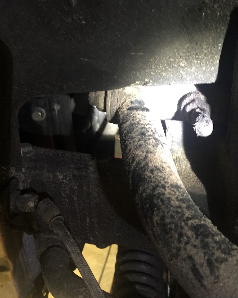

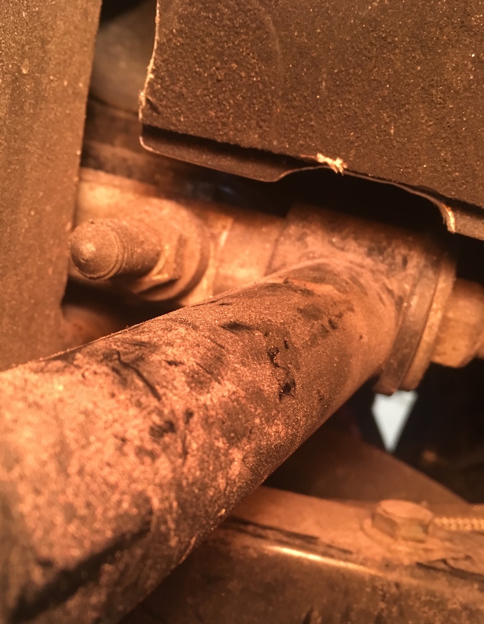

My first try was to adjust the coilovers to raise the front of the car, plus grinding away a bit of the inner fender panel which seemed to work. Here are some pretty bad photographs of the upper A-rms. The panel near the pivot points is what they were kissing if the springs deflected enough:

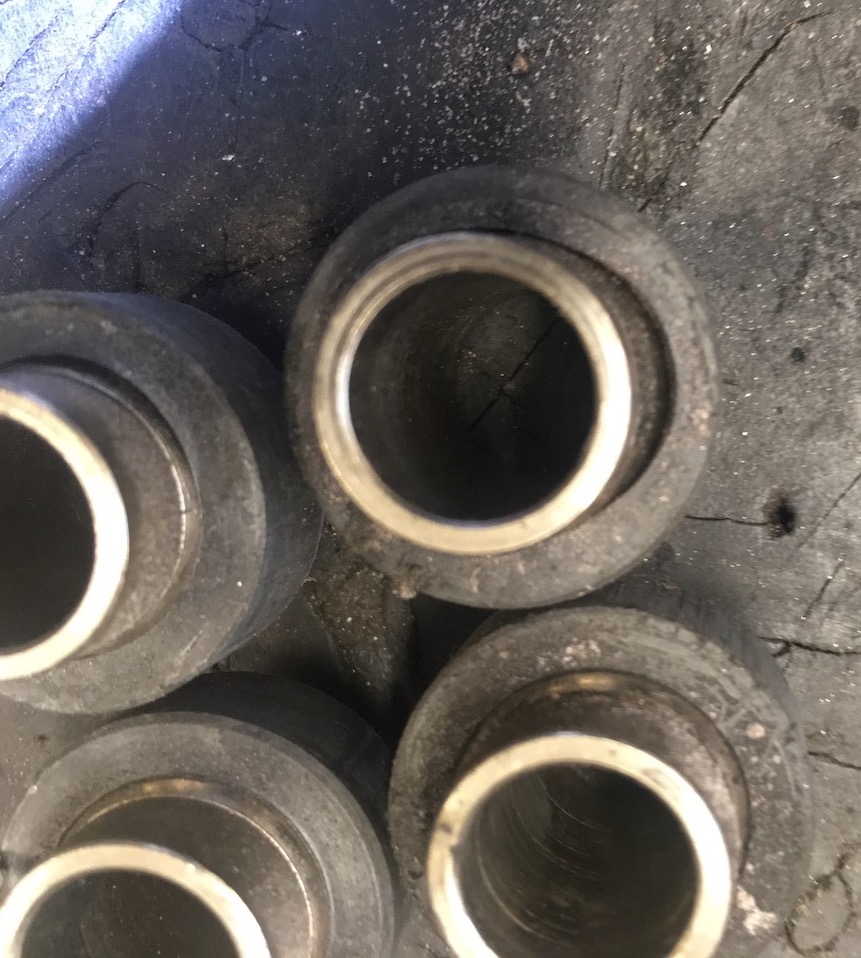

After some more thought and voodoo I checked the rod-end type mountings of the shocks AKA spherical bearings. Sure enough, over time they had compressed:
So Summit Racing got an order for a new set of ends which are due to arrive tomorrow.
