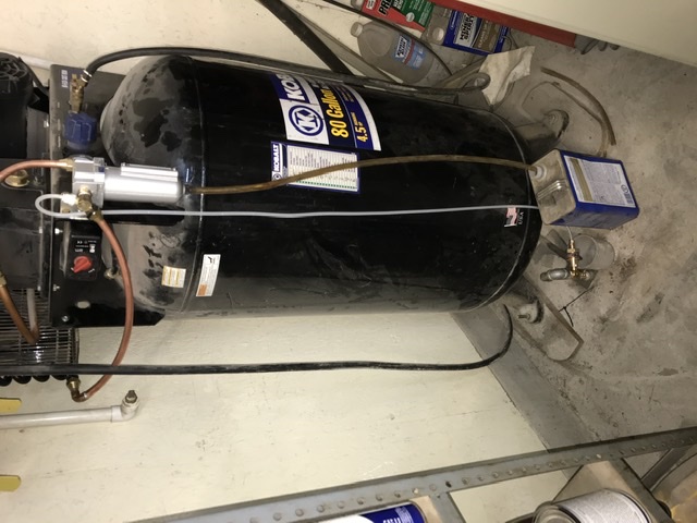

This is the finished product.

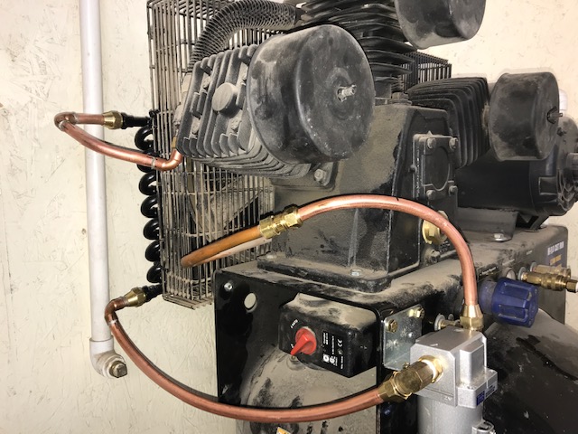

I disconnected the pump output line keeping it intact incase all goes poorly and I need to put things back like they were.
I took the output line and ran it to the top of the heat exchanger, from the bottom of the exchanger I ran a line to an automatic water separator then into the tank using the original line that I had disconnected. If cooling the air going into the tank makes it drop as much water as I think it will I'll attach a hose from the bottom of the separator to a container to keep from making a mess all around the compressor.

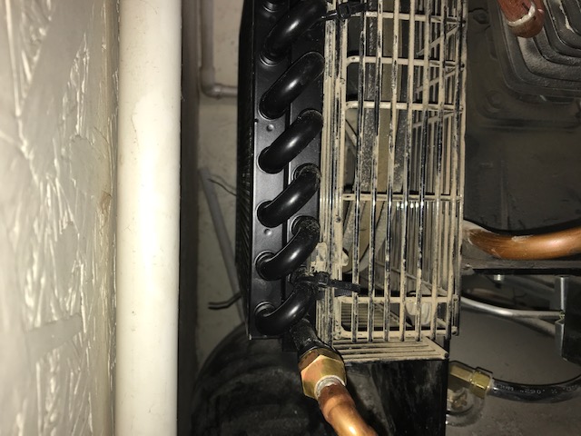

This is the exchanger (I think it is an oil cooler) attached in front of the pulley/fan of the compressor. I dropped it as low as I could so it does not affect the air moving over the cylinder heads.

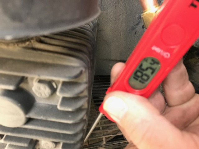

I took a temp reading while the compressor was filling back up. This is off the cylinder side.
And this is taken at the tank side after the water separator.
Quite a difference.

All finished. The pre-cooler water separator is working and the auto tank drain is doing its job too.
Sorry for the photo. The web site flipped it and I can’t get it vertical.
