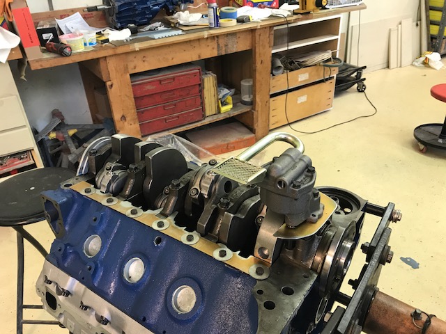

Just an update. I got the intake valve ok. Ferrea had the engineering plans for it and make one up special. Only cost double the price that Trick Flow had before it was discontinued . $50. Cheap sense if I could not get one it meant new heads, push rods, half set of rockers at the least.
Spent the day modifying the oil pan to make more room for the stroker crank. I hope that is the last of the fabrication I'll have to do.
Here are a couple of photos.
On the first one I'm sealing/gluing the crank oil scraper to the block and I have the rear journal scraper installed.
If I stay motivated I should have it running on the engine stand this weekend or before.

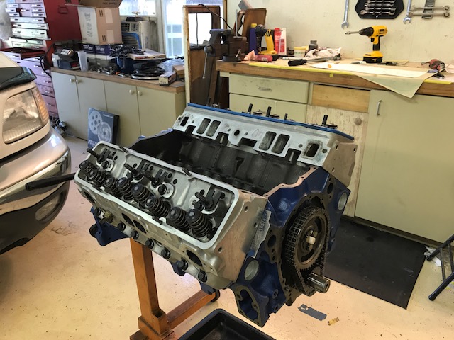

Plugging along. Lower end is done, valve train is finished. I updated the half of my rockers that were "eBay Chinese" to Comp Cam the other half were already Comp cam do to the offset intake valves. I felt that I was pushing my luck on those. I could just visualize all those needle bearing flowing thru the motor.
With any luck maybe the next update will be it running.

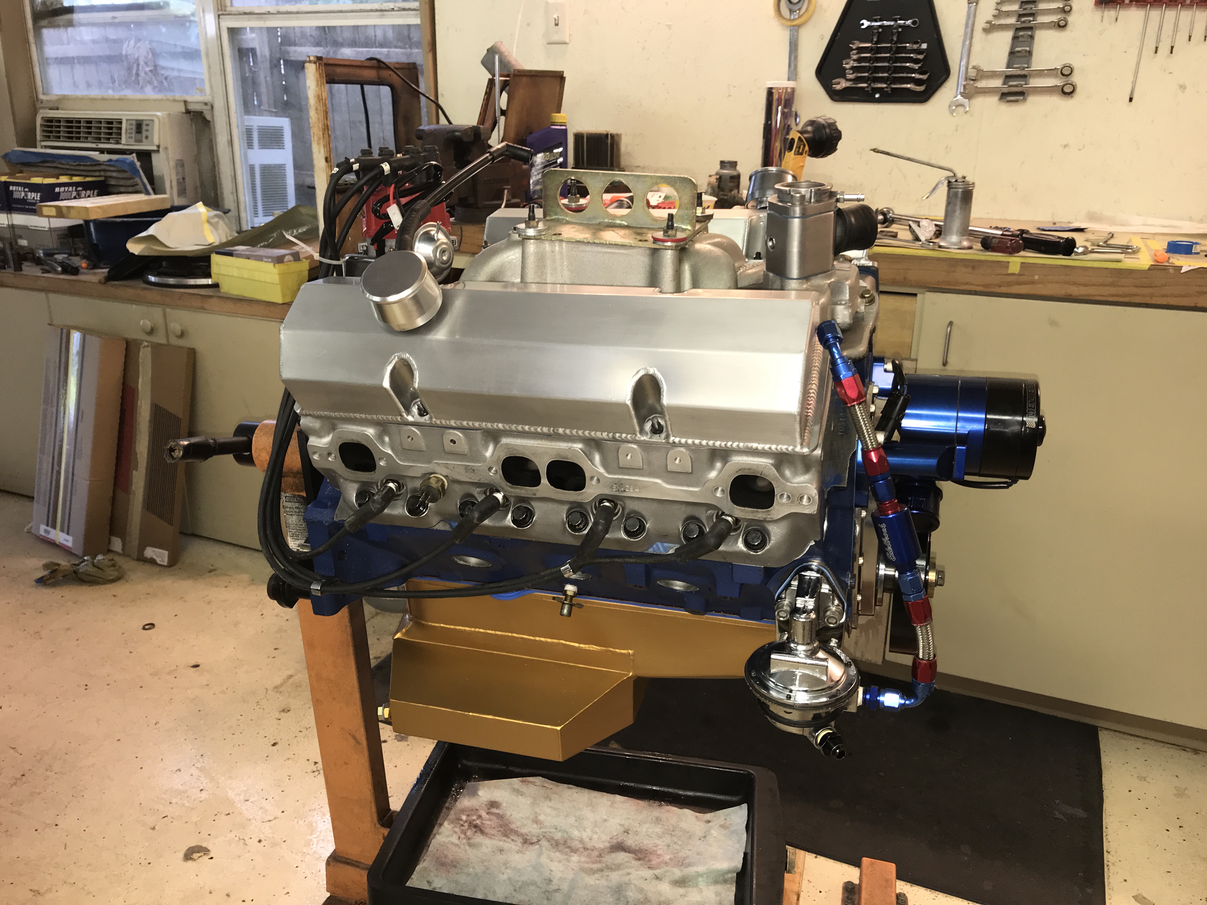

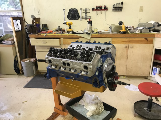

Engine is ready to put on the run stand.
Can't wait to hear it make some noise.
