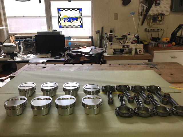

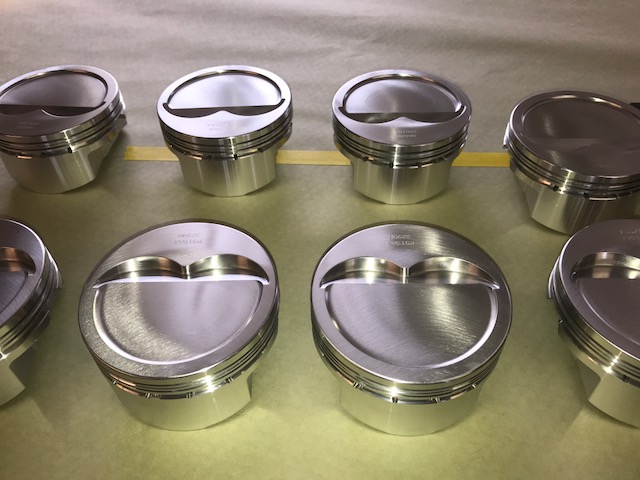

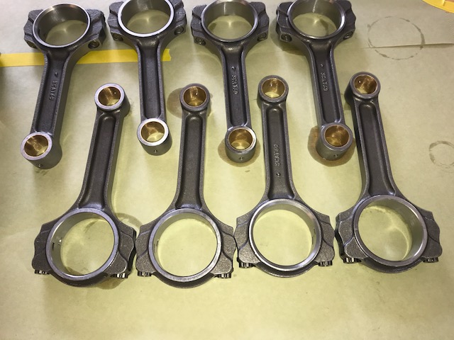

Shiny stuff has arrived.
It almost seems like a shame to put all these pretty parts in a hot hole and make them go up and down real fast.
- IMG_0725.JPG (82.17 KiB) Viewed 23770 times
- IMG_0724.JPG (93.27 KiB) Viewed 23770 times
- IMG_0723.JPG (93.79 KiB) Viewed 23771 times

Yep, I stepped it up a little bit. Went with forged pistons this time, I-beam rods with 7/16 arp bolts and floating wrist pins.
Compression should be right at 10.5.
4.155 bore with 3.875 stroke....421Ci.
Cam and heads are the same....had to same the budget somewhere..lol.

Ahh, it’s all good. Besides, they really are gorgeous parts. Pistons, anyway. Ken, why no H-beam rods? They are a little heavier, true, but boy o boy are they strong.

My research indicated they hit in too many places in the stock block with the longer stroke.
Re: Motor Parts
Ugh. Die grinder work. It is the pits. Can’t be faulted for wanting to avoid that.
