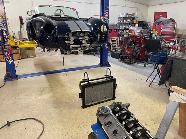

Here are the projects all lined up.
Radiator removed for access to the back side of the body damage, and the new block moved into the repair area.

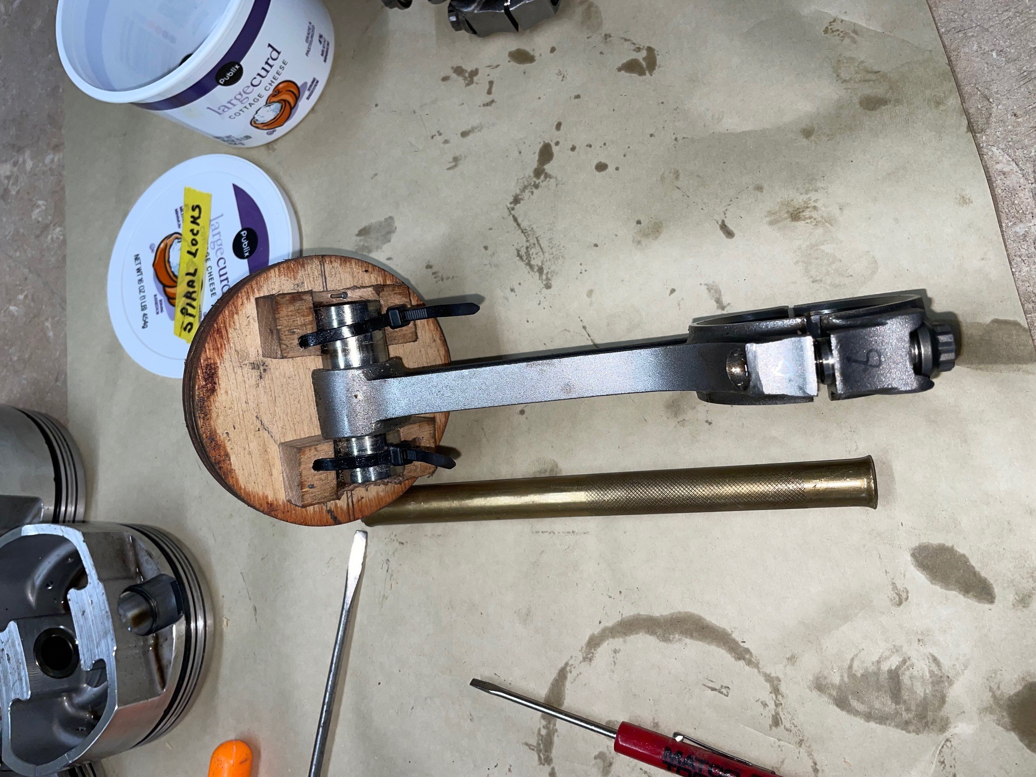

I decided to set the rod to block clearances in the new Dart block. So I put the crank in with the two end main caps and the bearings from the broken block. Then I grabbed a piston assy and tried to put the piston and rod into the block.....forgetting that the piston is .030 over size and the cylinder is .010 under size..so it didnt fit. :lol: :roll:
As I was hoping to have all my grinding done before I sent the block to the machine shop so that when it comes back all clean I dont make more metal shavings into the clean block.
After a lot of thought I reverted back to my wood tools and came up with this.

Re: Kens Cobra vers. 2.0
Are those zip ties accurate to .0001"? :lol:
Just wondering if the rod position is OK for a grinding reference....
Tom. Yes...it is plenty ok. I can see the ark of the travel and how it moves...also I have about almost twice the clearance that it needs. The rods are set up for a stroker. With the 12 point 7/16" heads it gives a lot of room. I really think that it would have been ok without any work as it was already clearanced for 3.75" and I have 3.875 but I touched it up anyway...Was lots less than what I did on the stock block.

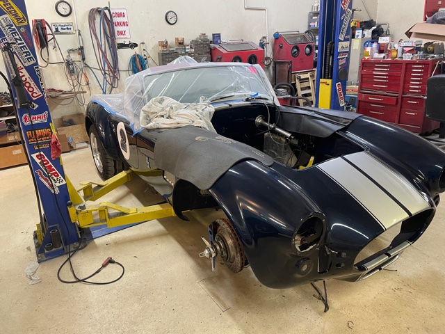

I’ve covered up the car to prepare todo what would scare off most folks..the next time I post I will have taken the grinder and totally destroy the paint on the front of the car.
But I have the time as I wait for the pistons to me made.
