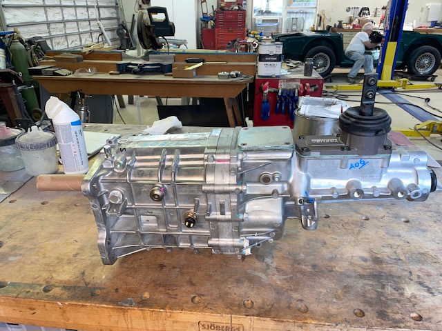

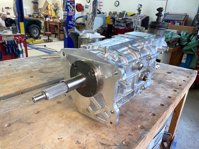

But here is the start of the blog....I had ordered a new Tremec TKX and it has showed up. I just had to show it off.

A lovely sight :!:

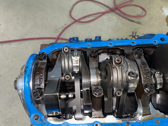

What is wrong with this picture. Hint below.

Make the picture bigger, it wasn’t a rod that broke.

I haven't seen that many engine failures but...
It looks as if that main cap needed six or eight bolts? Wonder what got it?
Maybe it just needed to be forged?

Yep it’s my first main cap failure. It’s just one of those things. I used that type of block in my racing car and never had an issue. But obviously it can happen.
I feel good that is wasn’t anything that I did other than making too much power in a block that was never designed to handle 500hp.
