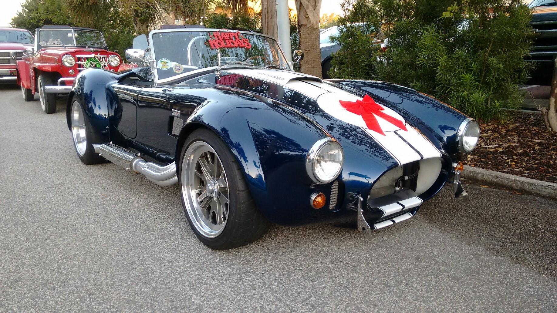

Well the starter came in at about 3:00 pm Friday ..] . Had it all wrapped up by 4:00 pm. Cleaned n polished car till 7:00 pm. We had a great time in the parade. Viper, our little Yorkie was a hit with the children. All in all everything worked out for the best. BTW the new starter performed 10 times better than the old one. The old starter must have been defective from the beginning. It would turn over like the motor was on a massive compression stroke every time I tried to start the motor.
