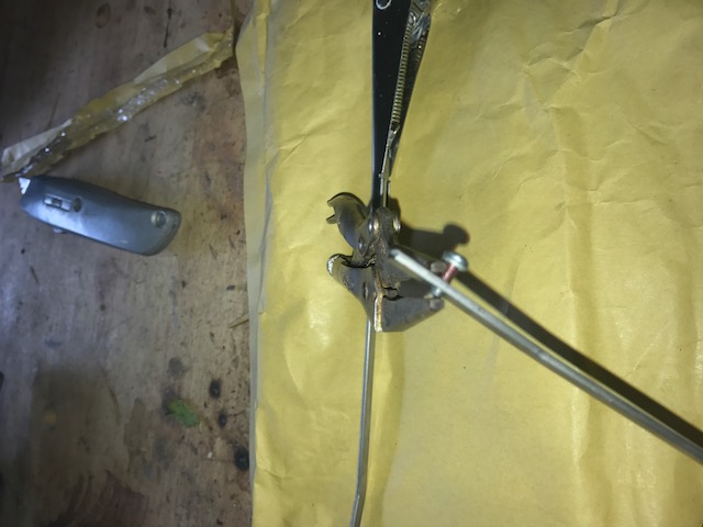

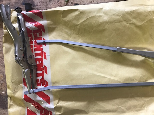

So I bought a Mini Cooper left park wiper arm to try. The angle of the arm was ok but the mounting base was too small. So I took the arm out and put it in my original base. All is good. Ebay only had the one arm when I bought it so I still needed another.
I took the other original arm shaft and flipped it over, drilled out the blade bump and tapped the hole then installed a screw. Now after the lock tight sets up I'll trim and file the screw to make a blade bump on what was the back side and I will have two left park wipers. As Edd would say from Wheel Dealer "Job Done".
