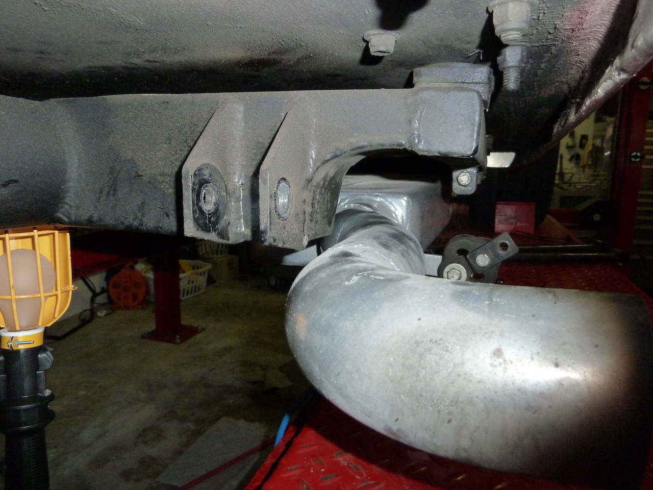

First, I find the front bolts won't come out until I move the sidepipes:
So I remove the pipe hanger bolts and loosen the three collector bolts to get the front trailing arm bolts out. Then I remove the bushings, find the dimensions and connect to Energy Suspension's web site. I locate bushings and sleeves that seem to match the measurements and order a set of four. They are due in next week, but I'll probably be in Georgia visiting family when they do arrive...

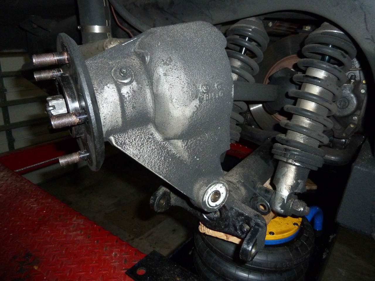

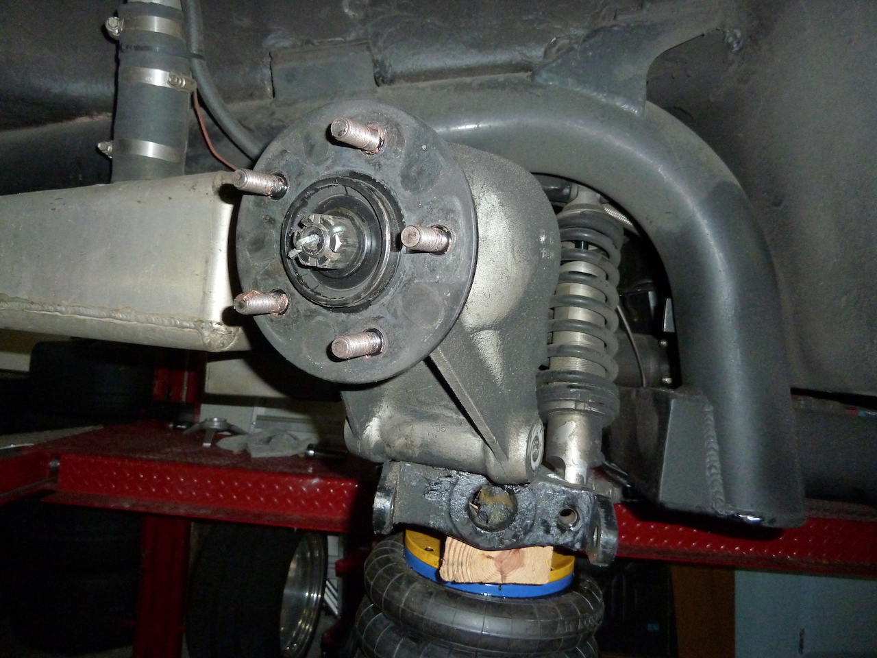

A closer look reveals that the outer end of each bolt, the head, is trapped between the wishbone and the hub. So the lower pivot shaft of the hub has to be removed, and the hub rotated out of the way:
Just jack up the rear, remove the wheel (after removing the spinner) and then remove the hub pivot rod.

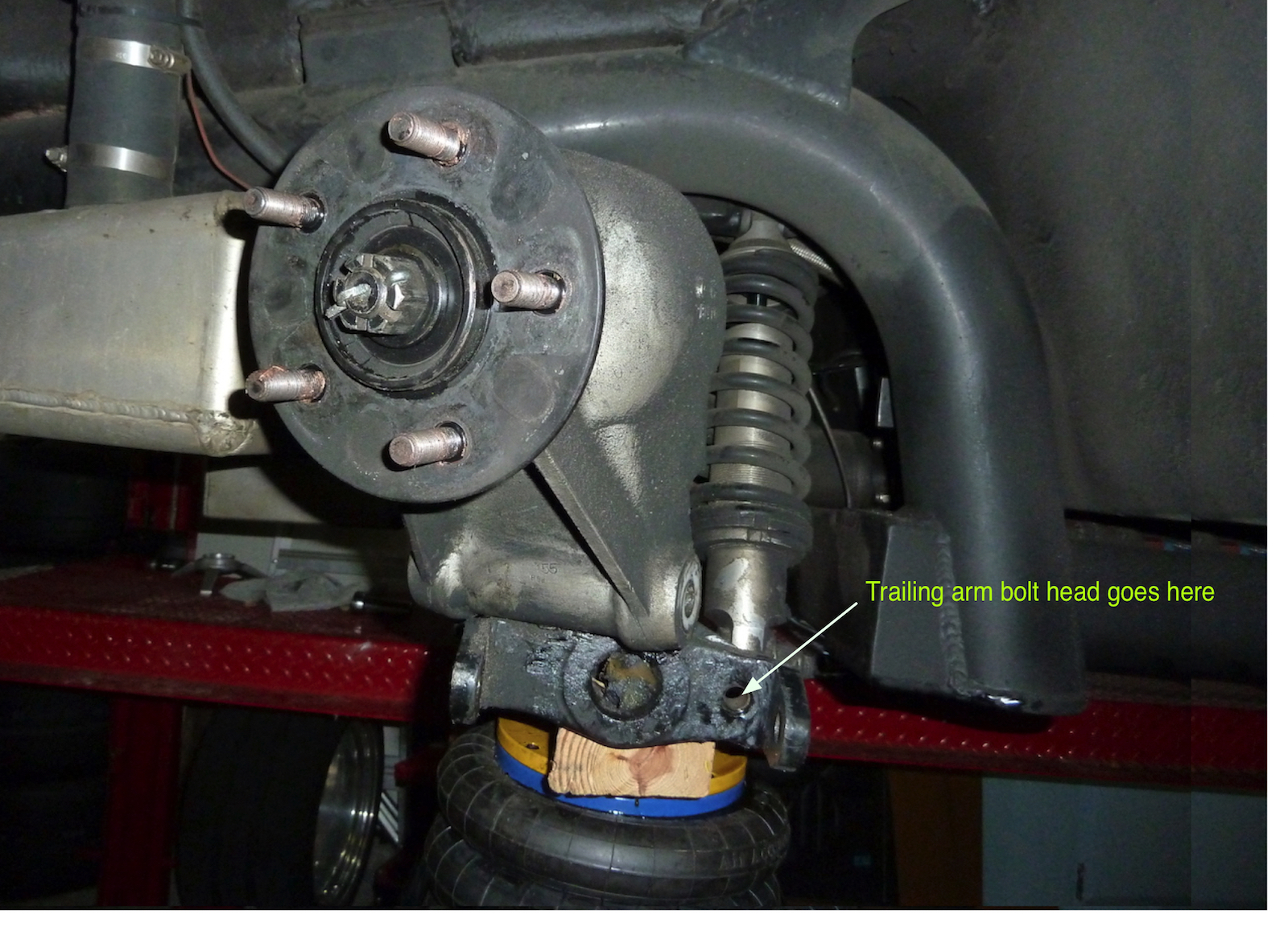

While removing the driver's side trailing arm bolt, I find it was too short to make the Nylock secure. So here we go again: buy a bolt that's too long, shorten it, then cut the head to 1/2 thickness because it will interfere with the hub pivot if I don't. Just the usual extra work (Bolts Right In!) Thank goodness for the Dremel and its reinforced metal cutoff disks.

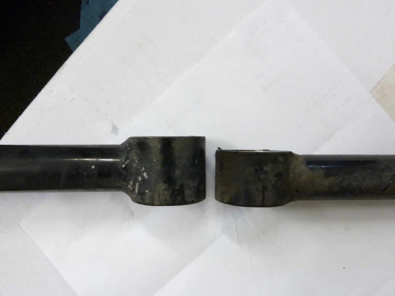

As you can guess, the fun isn't over yet. After removing the trailing arms, it looked like the ends were different front to back. Sure enough the front is wider than the back:

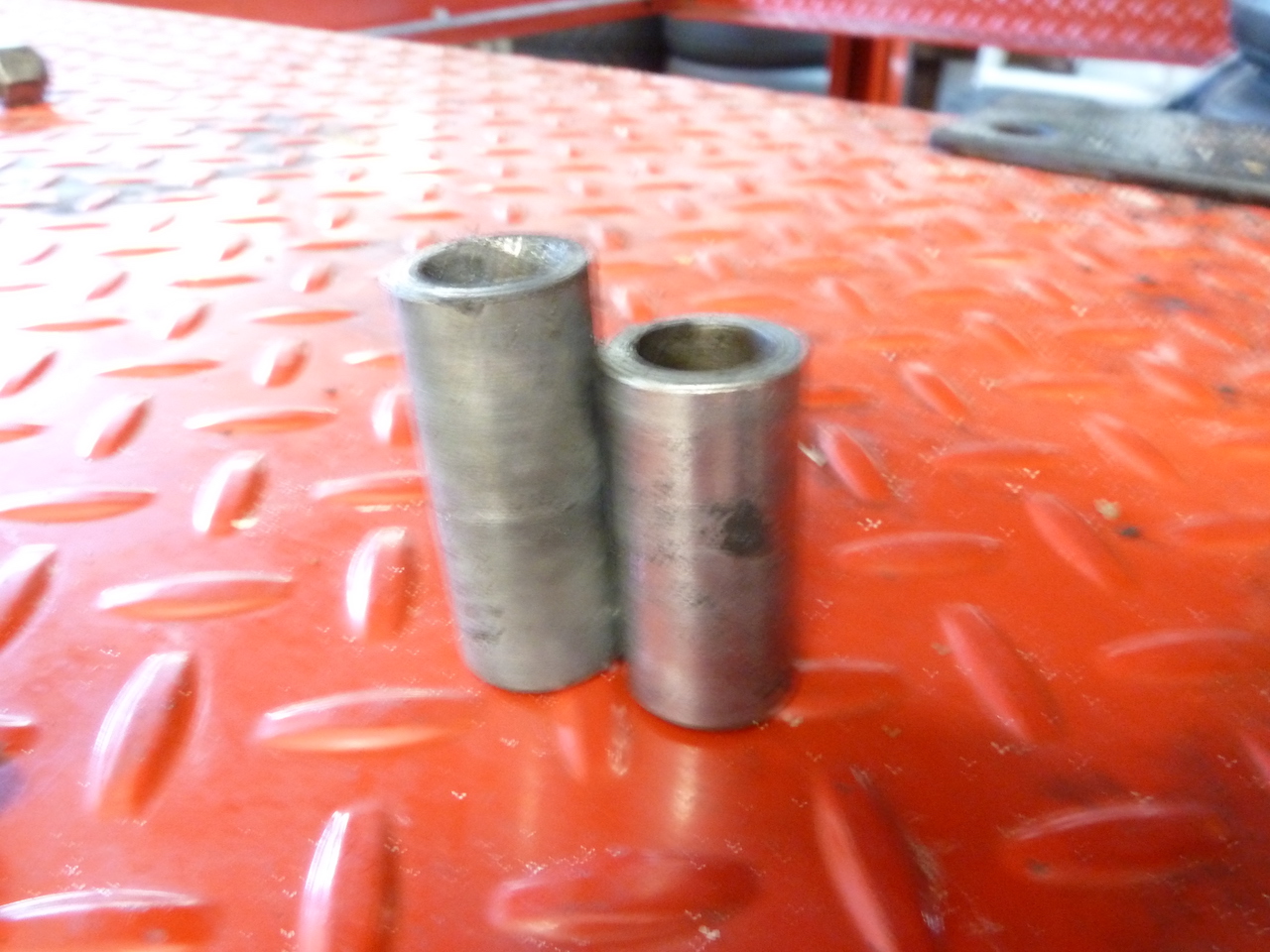

And the sleeves that fit inside the bushings are different widths:
This means that when the new bushings and sleeves arrive, the back ones need to be narrowed about 3/16 of an inch. Then maybe the thing can be reassembled.

Here's a better idea of where the rear trailing arm bolt is supposed to go:
First, the new bushings and sleeves were the correct ones. I used the 1/2" bolts clamped in the vise to hold the sleeves while I cut them off with a Dremel. Then slid the bushings on and cut them with a very sharp stainless knife. Having the vise hold the pieces was the key to getting a flat cut - almost like having a lathe (how much would a small lathe cost anyway?)
