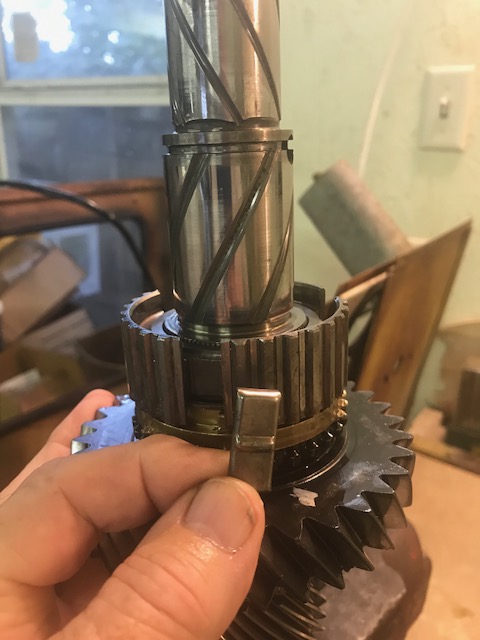

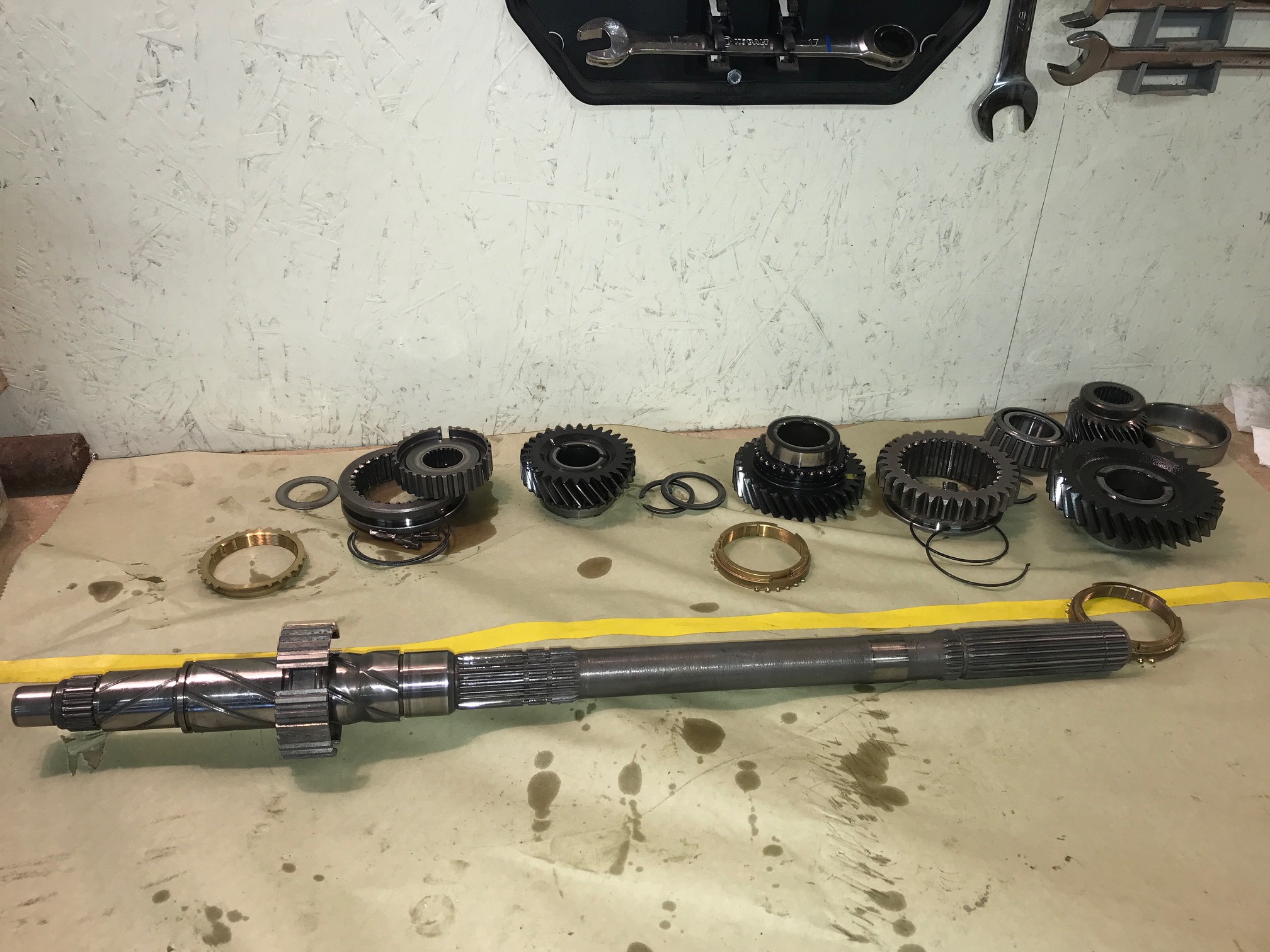

I have taken apart the main shaft and found my first group of issues (I don't know if they are problems yet).
While all YouTube videos and information on the web are for Ford, everyone notes that the GM internals are "nearly" the same. Now I have to admit that I have no idea of the history of this transmission. It was an eBay purchase and it had been gone thru at least one disassembly (I wont call it an overhaul) as there are miss matched parts. The cover is date coded 1983 and the main case is 1989. GM didn't use a WC T-5 until 1988 as best as I can tell.
My first trouble is the 3-4 slider's indent pins are at least 3x's larger than any that I have seen on any video. Also larger than the GM kit I got from the supplier. Then there is a thrust washer that has a tang built into it. No videos have ever shown that either. Also not in the kit. Then there is the fact that all videos have caged roller bearings for the gears. Mine does not have any caged bearings.
So I have sent an email with photos to the supplier and I'm waiting for the return contact. He is located in Jupiter Fl. So a road trip is not out of the question if needed.

The parts supplier called me back even thou he was at a show in Indianapolis In. As with most eBay items mine was not quite as advertised. It turned out that I have a World Class cluster, case and input shaft. All the rest of the parts are non-world class so it is a bit of a hybrid.(how's that for using the "H" word in a cobra forum).
So I am exploring my options. To put it back the way it was or upgrade all the wrong parts to WC.
