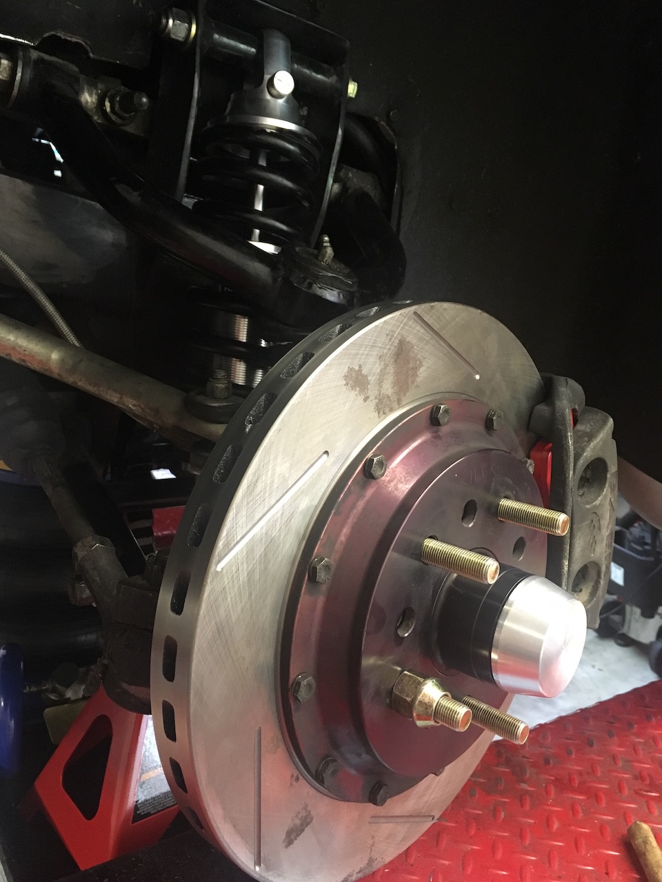

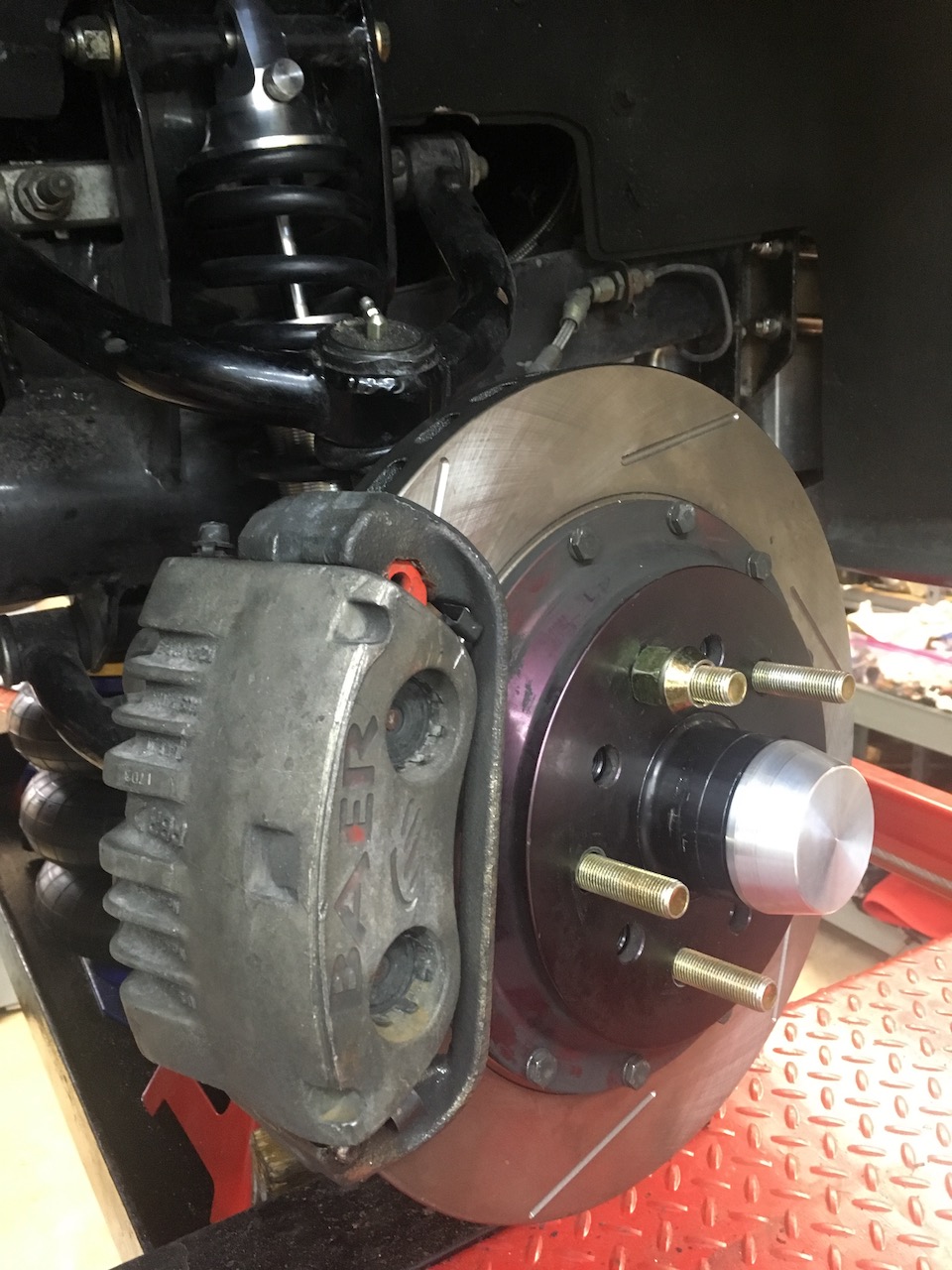

Just to make sure I did get something done over the holiday on the Cobra, Here are a couple of pictures:
In each picture is a new coilover shock, new rotor, new pads and a new hub.
Now working on installing new rear pads. After that, flushing brake fluid and road test including bedding the new pads. So far everything has "bolted right in" - as most of you know that represents major sarcasm...

The wagon has more weight on the front, and has the same calipers as the Cobra. The wagon uses the FoMoCo Cobra vented rotors where the Cobra uses the Baer two-piece vented rotors. I'd guess the difference is more because of the front end weight than the rotor type.
