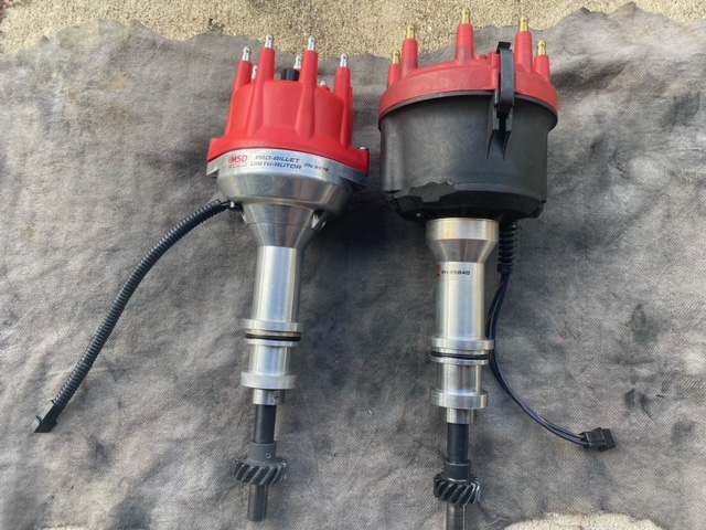

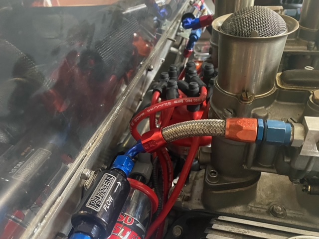

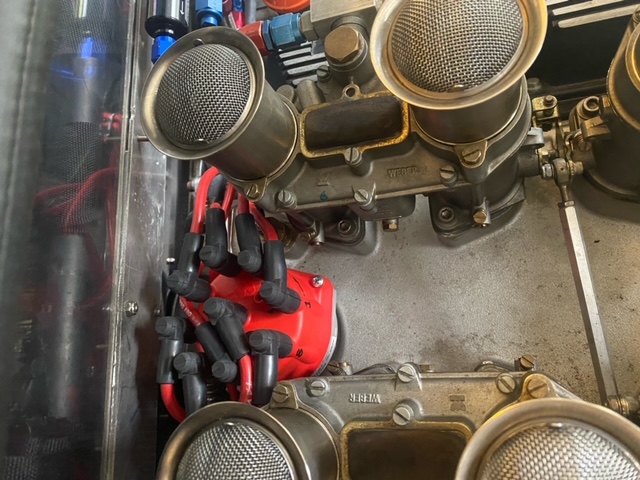

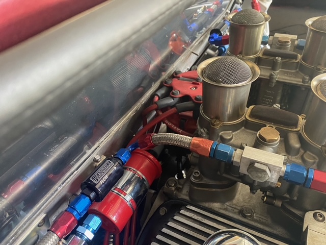

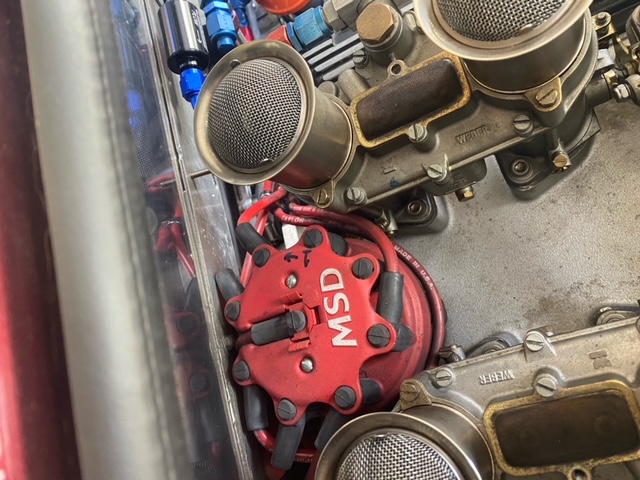

Since I was knee deep in distributors and carbs already, I decided to get on with the planned distributor swap for the GT. The Ford Racing 392w stroker crate motor came with the very large diameter cap MSD (PN 85840), which is pushed right up against the firewall/bulkhead. Not a good situation. Pictures below after I resize them.
Tom graciously provided me with a small cap MSD version (PN 8578) he had sitting in his garage with a recently installed steel drive gear perfect for my application. I owe you a bottle of single malt for that Tom…😉

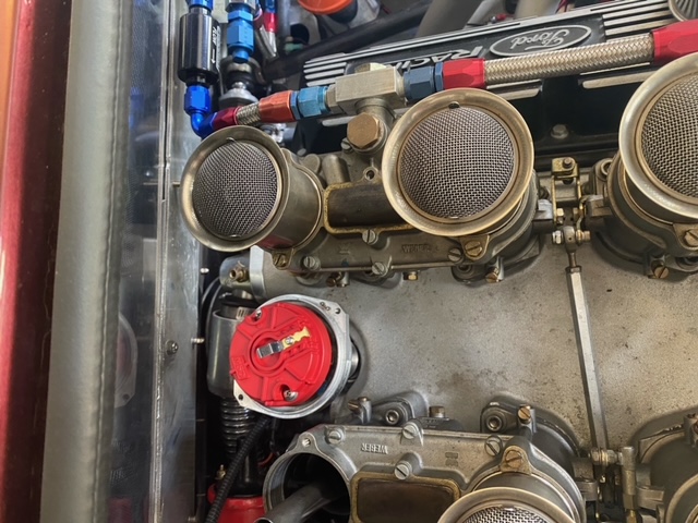

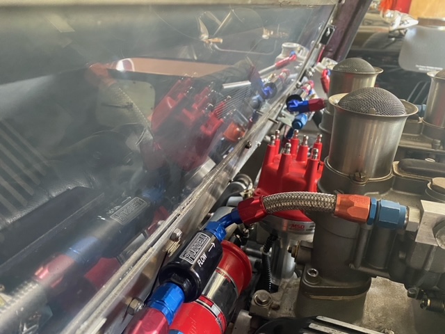

Popped the large one out with less effort than I was expecting due to the limited clearance as installed, and dropped in the smaller replacement without a hitch.
Since that was the first look I’ve had inside the distributor on the GT, I was curious to see how it was setup in regards to the advance curve. Surprisingly, it had the smallish silver bushing along with the two heavy silver springs. Not at all appropriate for this motor, which needs light springs
(1 lt blue and 1 lt silver) to allow advance to be all in at 2500 and the large black bushing to limit advance to 18 degrees. Now the Cobra and the GT are setup with the same curves as appropriate for very similar engine configs.

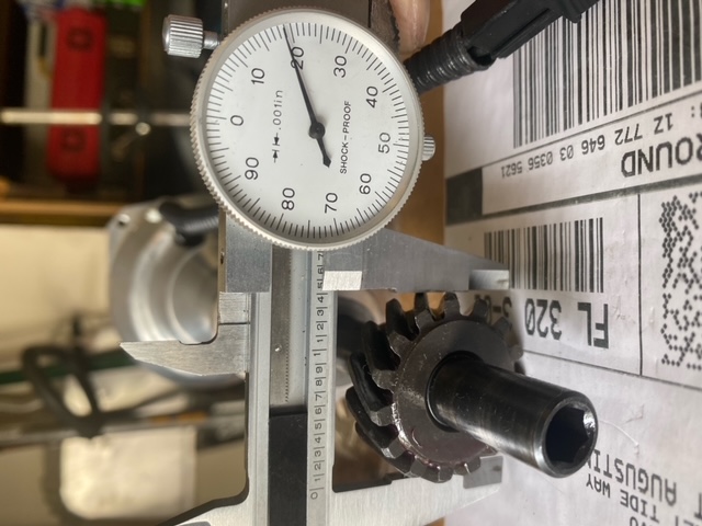

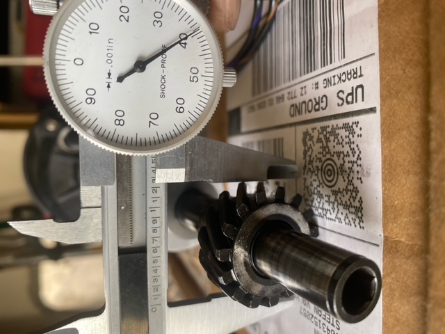

So, as it turns out, the steel gear MSD installed on the 8578 distributor is intended for 351C (and others), not 351W as was assumed. Couldn’t understand why the distributor just wouldn’t drop fully into place, so I started looking at the units in detail.
The PN 85813 gear is approximately .180” larger in diameter than the PN 85834 gear installed on the large distributor. 😳
Guess I have more work to do. 😎

Looks like MSD 85834 will fit if the shaft is .531" Probably best to call MSD directly.
Re: Cobra and GT distributor and carb updates.
No worries Tom, I swapped gears around…success, it dropped right in this time…😎
Lots of room now, and hopefully the more aggressive advance curve will wake this motor up! 😉
