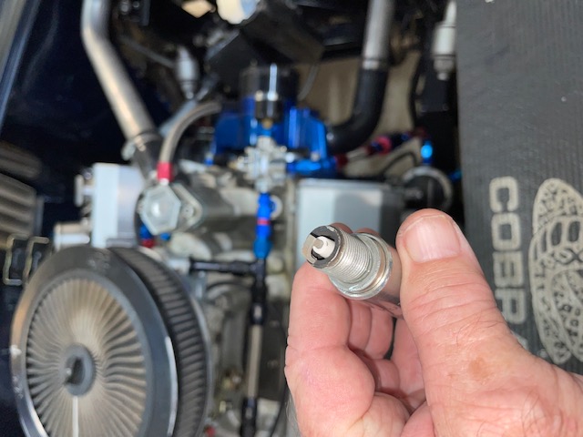

Here is the plug after the first test run.
Looks like I may need to drop the plug heat range back a step which is a good thing.

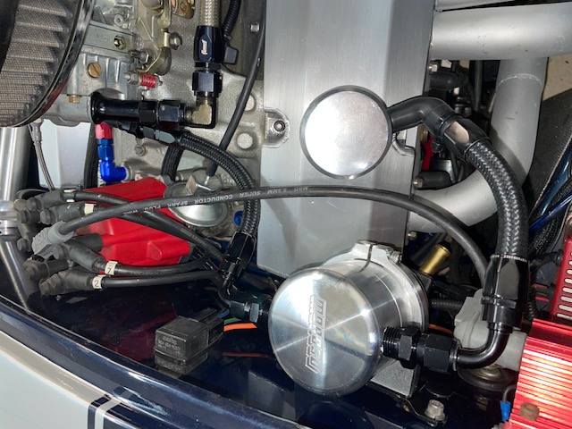

I also added a oil separator between the pvc valve and the vacuum port at the carb base. As I keep saying “it’s the bling” that costs the most. The kit came with brass fittings and hose that would have worked ok. But I had to bling it up a bit. The fittings cost almost as much as the separator.
