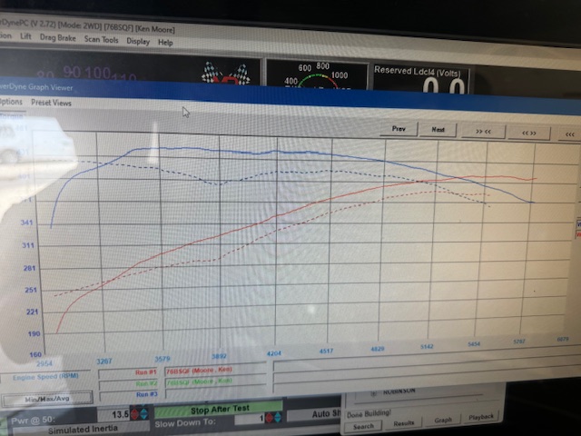

The tuner is to send me better printouts once he fires up his Dyno computer again. He had taken this photo of the results as he was tuning it.
The dotted line is one of the runs before he had done much tuning (or any I'm not sure).
The red line is Horsepower, and the blue is torque. As I mentioned before he has told me that his Dyno does not read the same as most if not all of his competitors. So, the number is more relative than perhaps comparative.
When I picked it up, he said that using his experience against other Dynos my HP at the wheels should be 475ish. It showed 465 with the other dyno that I had used with the Carb.
I don't remember what peak torque was exactly, but it was over 500. I'm hoping the other printout of the final pull will show more.
That being said both the HP and TQ hit fast and stay flat for a long time....good numbers.
