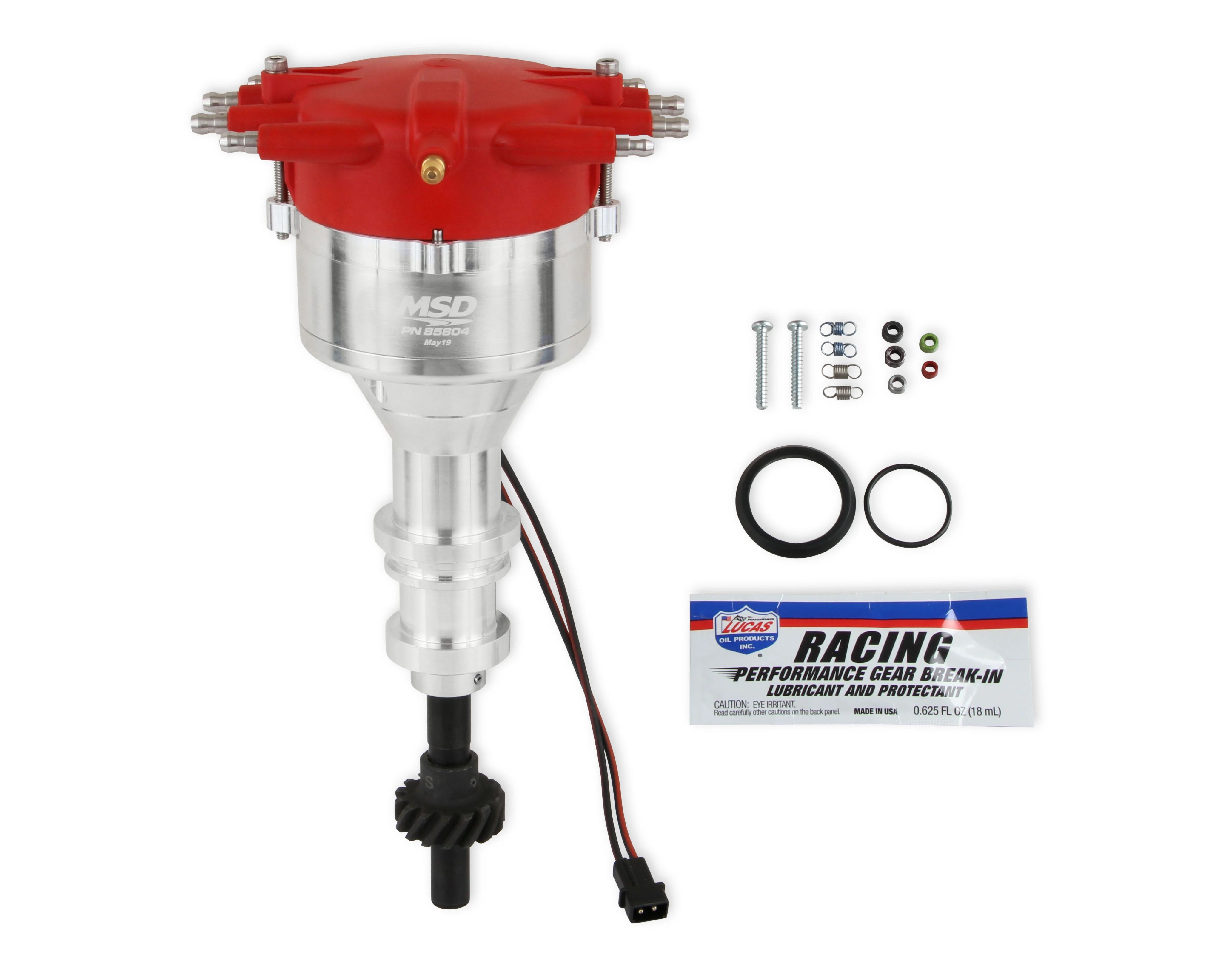

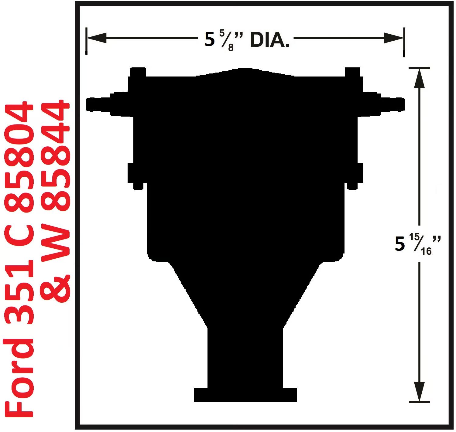

This distributor, MSD 8577, is a full inch taller than the old one:
MSD 8577_dim.jpg (36.9 KiB) Viewed 92884 times

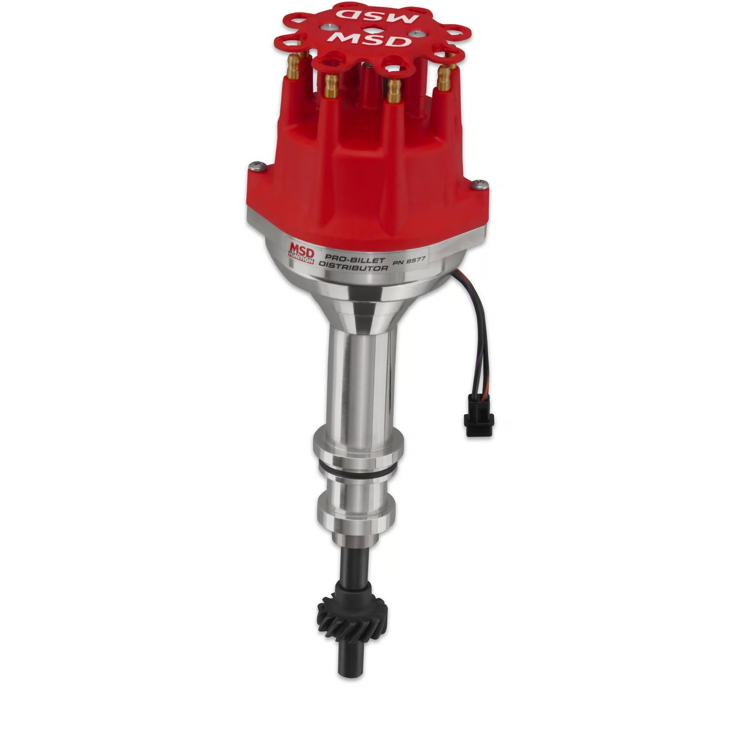

This what it actually looks like:
So, now what? Another hole in the hood? A Crab Cap MSD for another $654? Will the Crab Cap even fit?

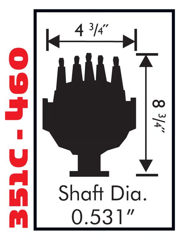

Details:
Dimensions:

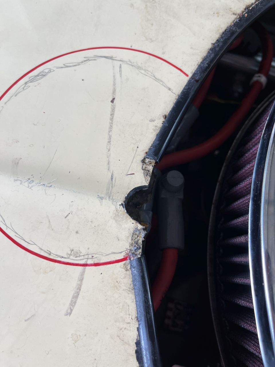

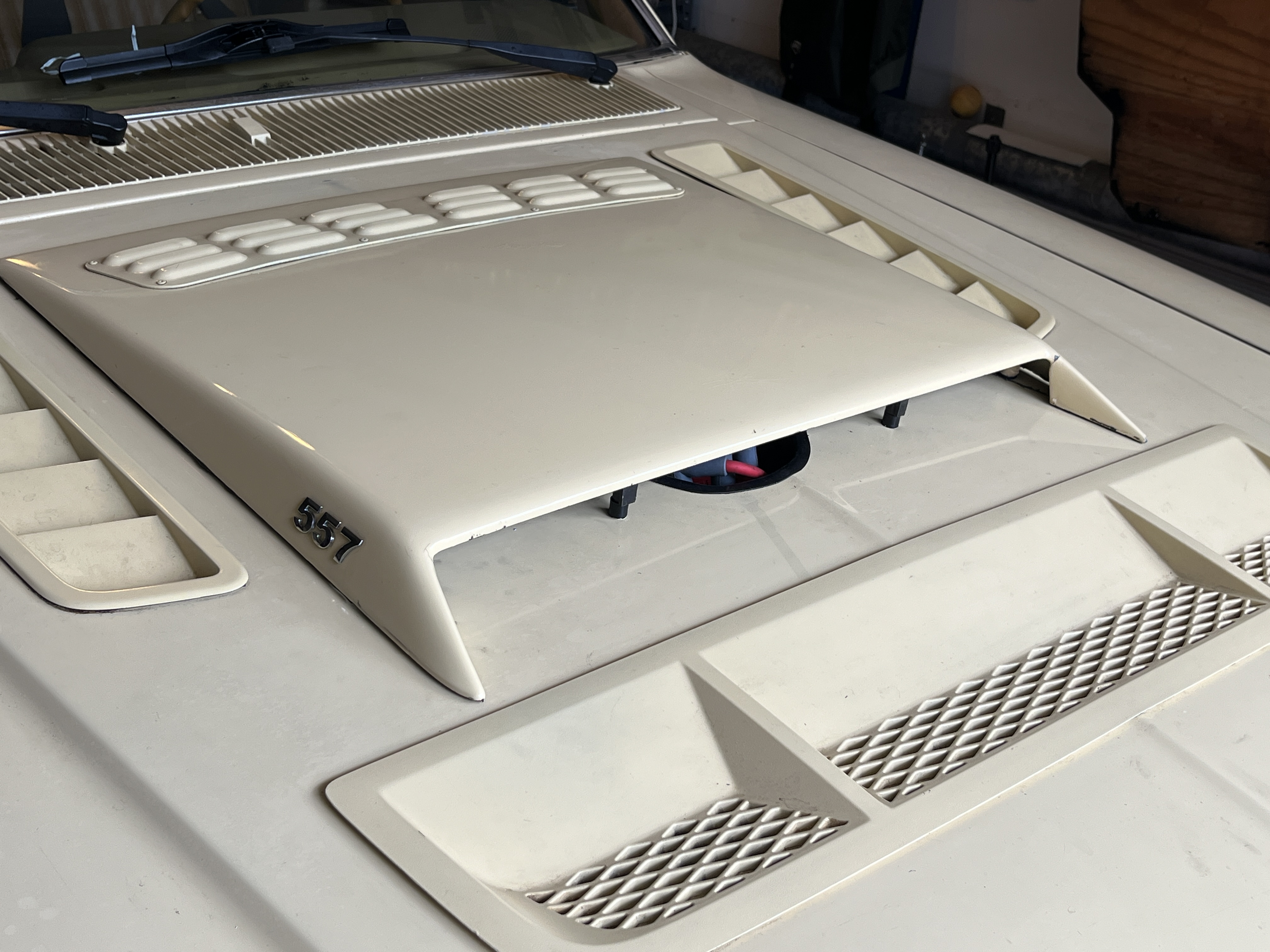

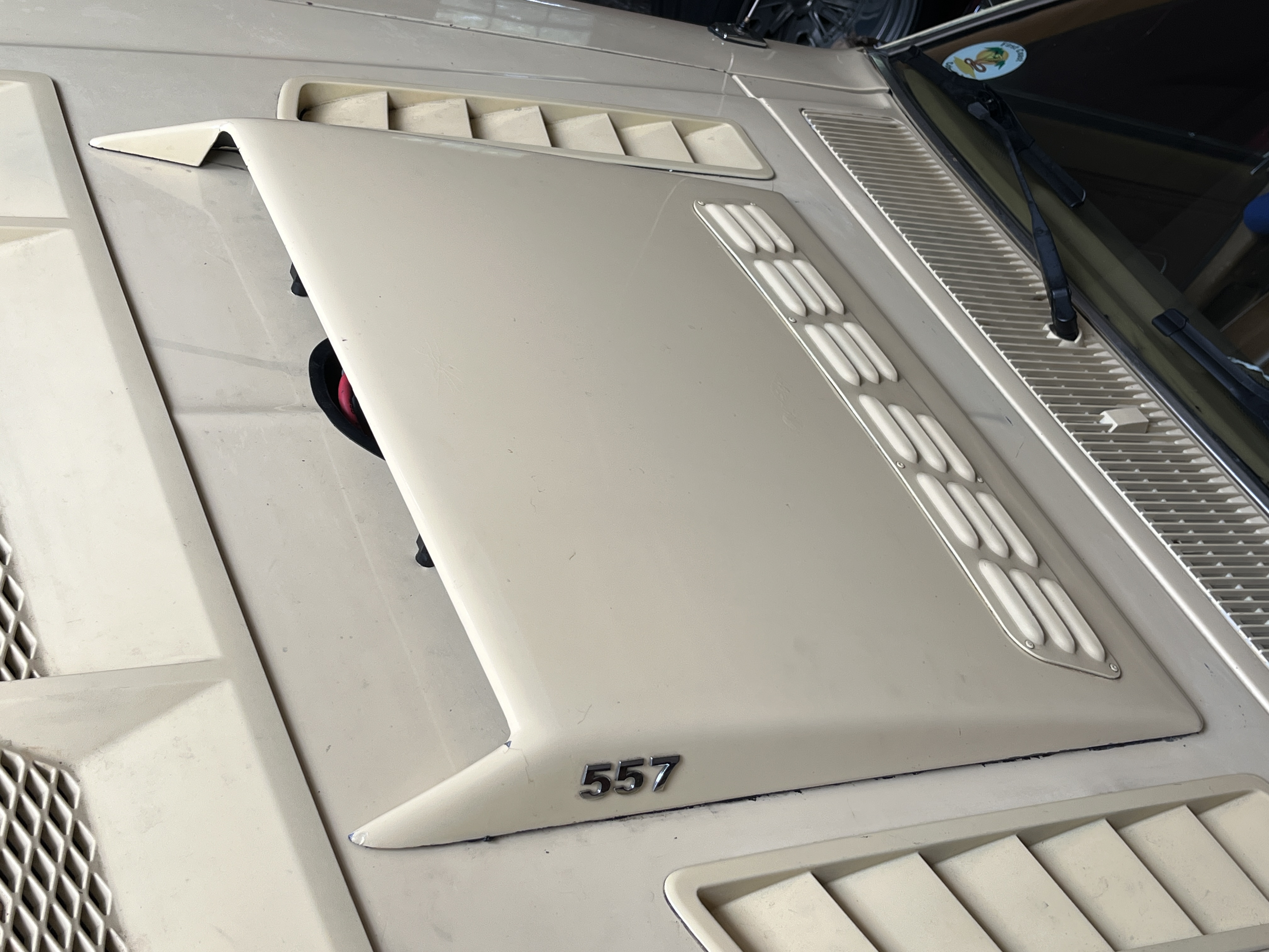

I plan to cut a hole in the hood at the front of the scoop and then move the scoop forward 2-1/4".
Here's the hood with the scoop off:
The red circle shows where the 4-5/8" holesaw will be applied.
Here's a closer view showing the rear of the distributor cap:
The hood lacks about 1-1/2" of closing so I think the scoop will clear the plug wires vertically. You can see (just) the top rear of the distributor cap in front of the air cleaner in the top picture. Those wires should end up about an inch higher than shown with respect to the hood after the hole allows the hood to close.
Some touchup paint will likely be needed - I know where to get some.
As always, there's a complication: a hood brace runs across in front of the air cleaner - the sharp-eyed will notice a little notch inside the open portion of the red circle. That's where the brace runs across. I'll need to fabricate something to bridge that part.

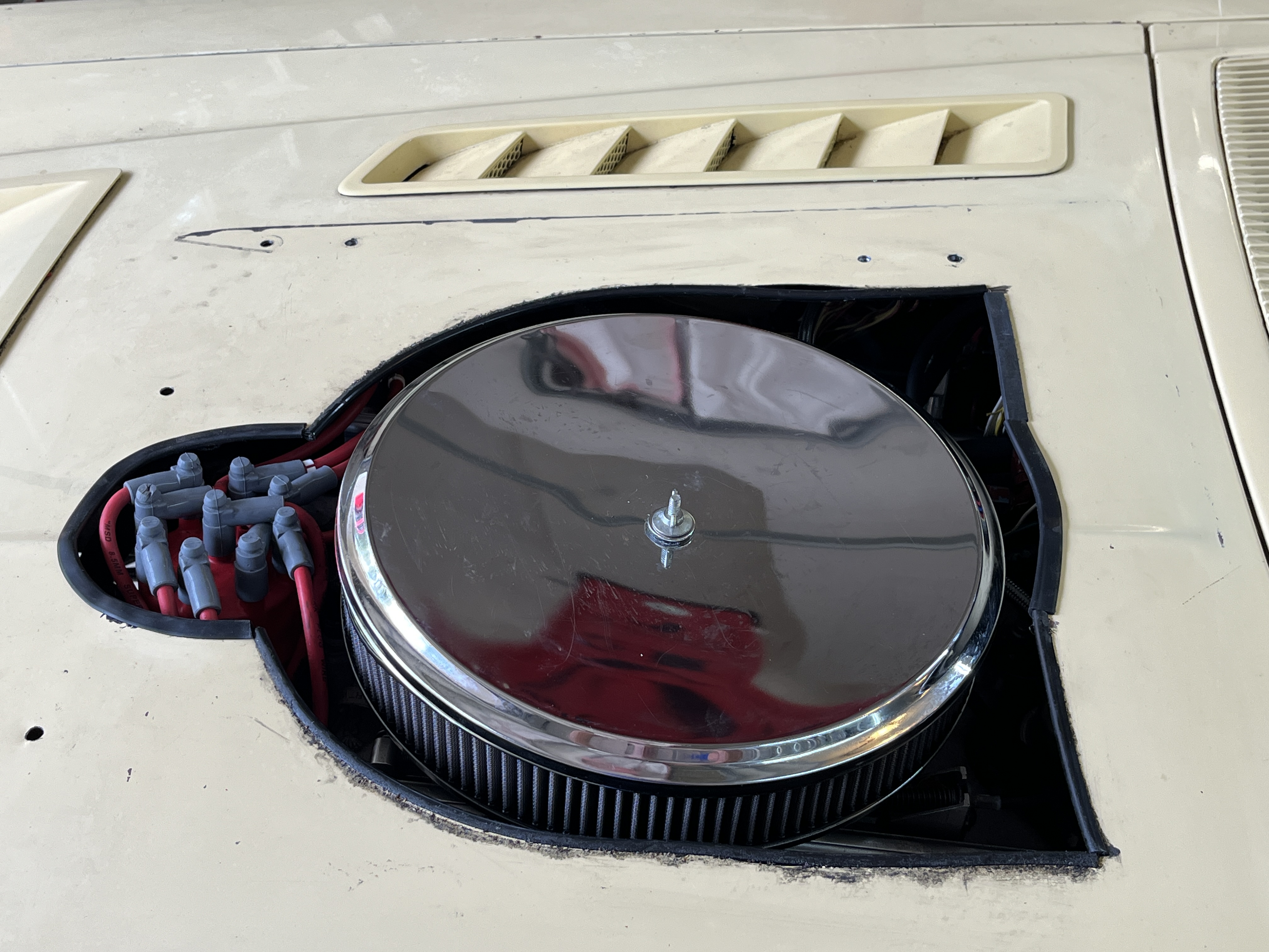

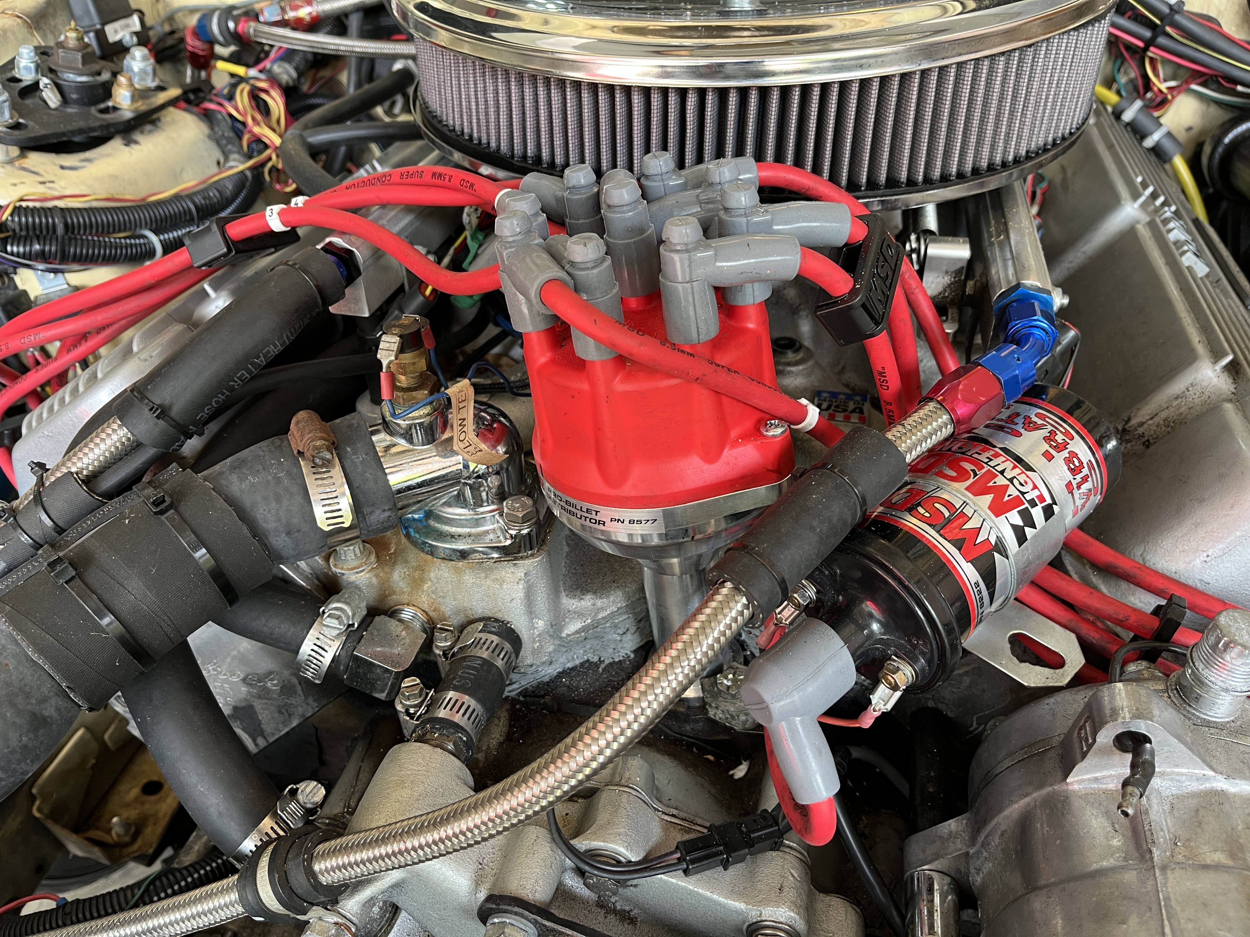

A few more pictures; first the new distributor and coil in place:
Coil and distributor.JPG (3.83 MiB) Viewed 92826 times
Then the modified hood opening:
Hood cutout.JPG (2.12 MiB) Viewed 92826 times

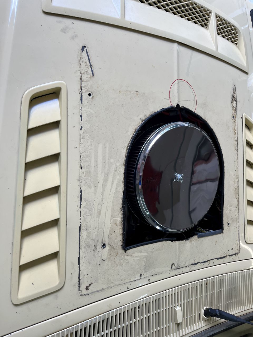

Finally the modified scoop:
Scoop 1.JPG (1.93 MiB) Viewed 92826 times
Scoop 2.JPG (1.97 MiB) Viewed 92826 times
The scoop ended up 2-1/4" farther forward because of the extended cutout for the distributor. Still awaiting a couple of parts for attaching the scoop. After that, I hope it's done!
